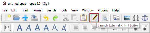

@Norrin Once you've specified the PageEdit path via Edit > Preferences > General Settings you can open the current file in PageEdit by pressing F2. There's also a new Launch External Xhtml Editor button in the toolbar.
