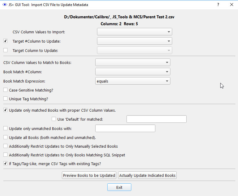

I haven't got the single tag matching option.
Name:	Import CSV File to Update Metadata.png

Old 06-13-2019, 02:12 PM   #478
DaltonST
Deviser
DaltonST's Avatar
Posts: 2,265
Karma: 2090983
Join Date: Aug 2013
Location: Texas
Sorry, I meant the "Unique Tag Matching" checkbox. Its ToolTips talk about a "single" Tag.
Old 06-13-2019, 02:22 PM   #479
Tanjamuse
Posts: 1,327
Karma: 5306
Join Date: Jan 2014
I don't have the checkmark in that.
Below is the screenshot from my latest run and the debug-log.
