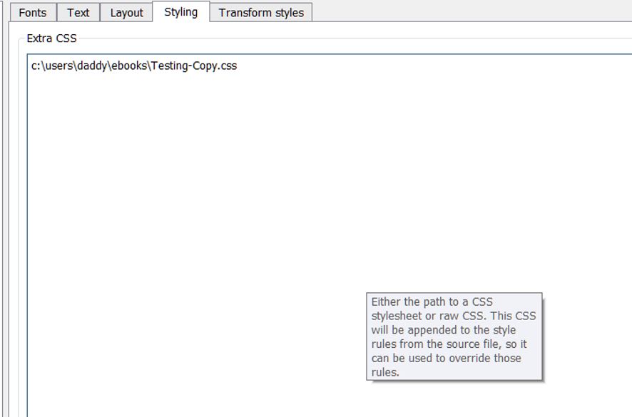

I put the path to the CSS I wanted to append like the tooltip says, but it seems the PI put the path into the doc's style sheets
I pasted in all of the CSS in the file and the PI seems to like that
The test doc had 3 stylesheets (no overlapping classes), and I checked all 3 -- the CSS was appended to all 3

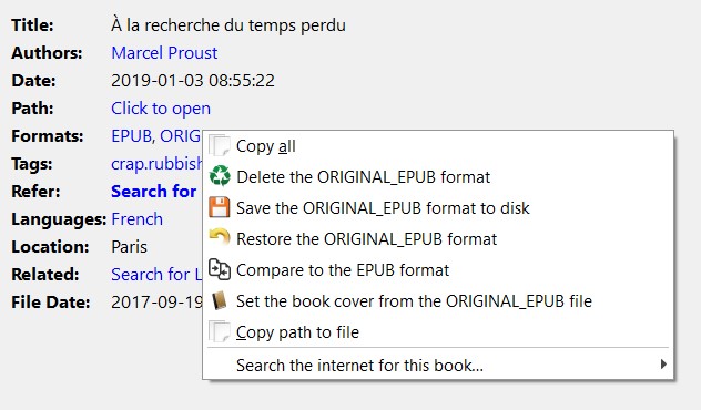

The PI (and other things) create ORIGINAL_EPUB files. How do I revert back to the original version? I can remove selected formats, but I couldn't see a way to just go back
Right click on it in Book Details, viz:

Old 05-06-2019, 11:12 PM   #1235
phossler
Posts: 1,092
Karma: 447222
Device: Kindle Paperwhite
Thanks -- much easier than the clumsy way I was doing it

What I was trying to say is that:
1. The Calibre tooltip says you can put the PATH to a CSS file into the Conversion -- Common Options -- Look & Feel -- Styling tab -- Extra CSS box, BUT the Modify PI "Append Extra CSS" check box only uses 'raw' CSS. If you have just the path, then it doesn't seem to do anything (understandable, but a message would be nice). That initially caused some head scratching
2. If you have more than one style sheet, the PI appends the CSS to each. Guess it has no way to know, unless it asked in those cases. That seems to clutter things, and leaves the appended classes defined multiple times
3. I guess I have a very personal opinion about using controls (such as the Styling text box) for uses that I thing were other than what they were intended for. The Styling textbox is under Conversion, but Modify ePub PI uses it. Yes, it is sort of a conversion, but IMHO it's a stretch
4. I like the PI and use it to make my life easier. There's a few quirks that a separate configuration 'page' would make easier. Including a more current Help that lists all available features and details about using them
