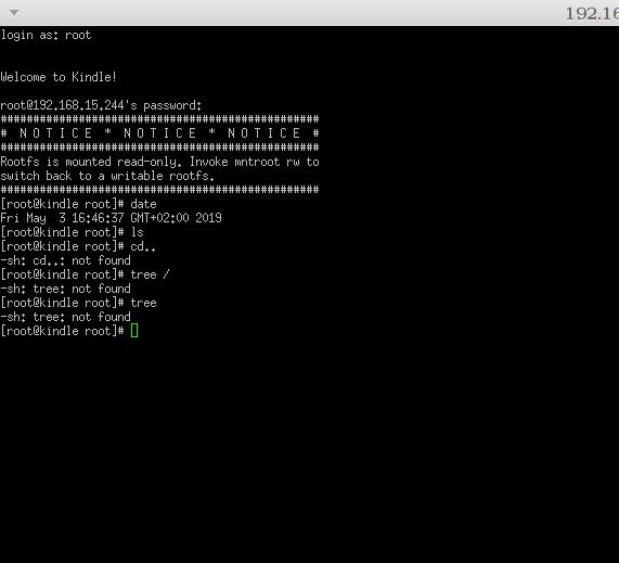

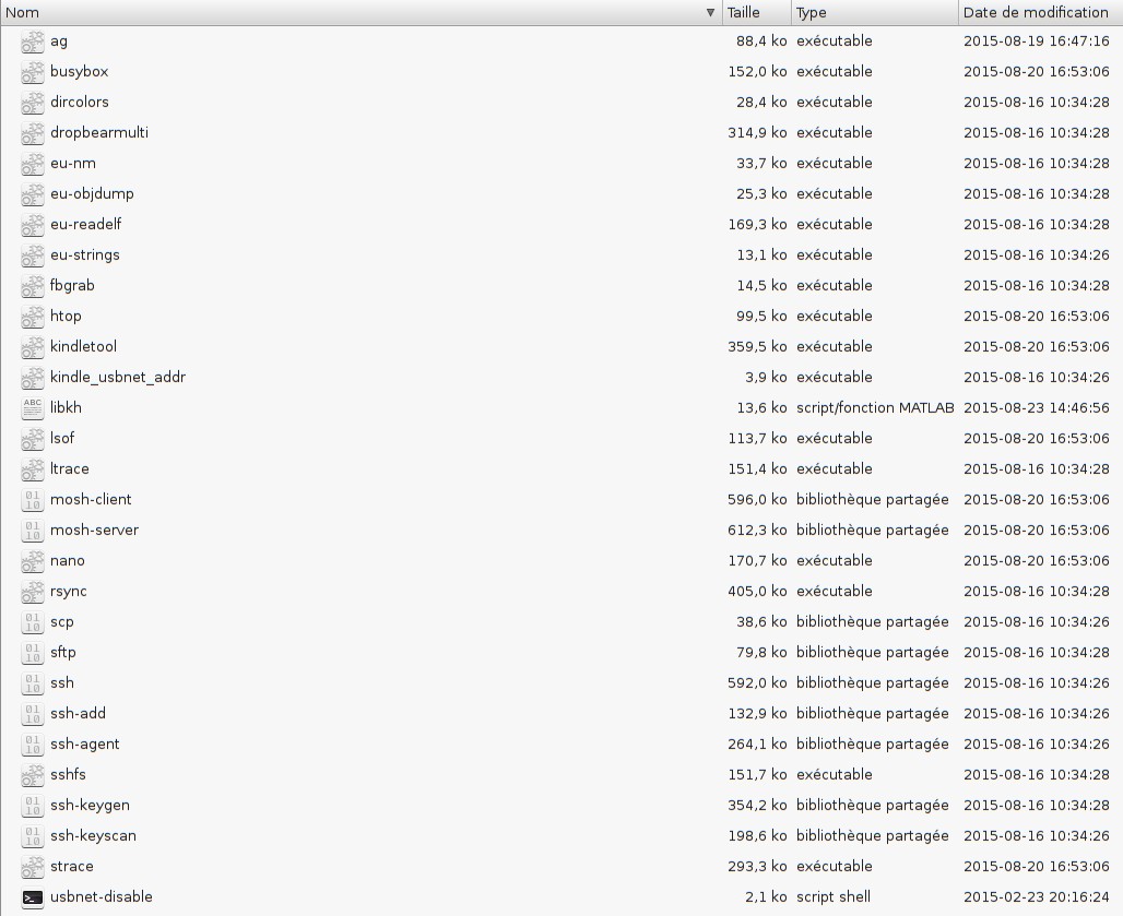

Bin repertory

All works as expected, PEBKAC.
I suggest you pick up a copy of TLCL and give it a read.
http://linuxcommand.org/tlcl.php
Linux Journey also isn't bad for some basic info.
https://linuxjourney.com/

SHAME on me...
Sorrry, SHAME on me ...
Thanks for pointing my stupidity. I'm under Mint since 5 years, but forget this stupid space under a terminal.

Find it: cd.. is for Win... What a shame...
