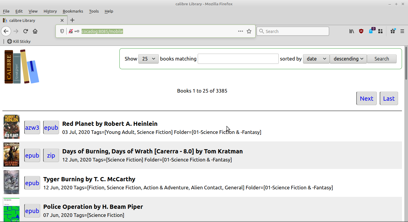

Use http://xxxxxx:8080/mobile on your Aura web browser address line. Replace xxxxxx with your calibre server name or ip address.
Should work with lateness calibre version.
bernie
note:
I use a non standard port number.
Name:	Screenshot from 2020-07-03 20-05-13.png
