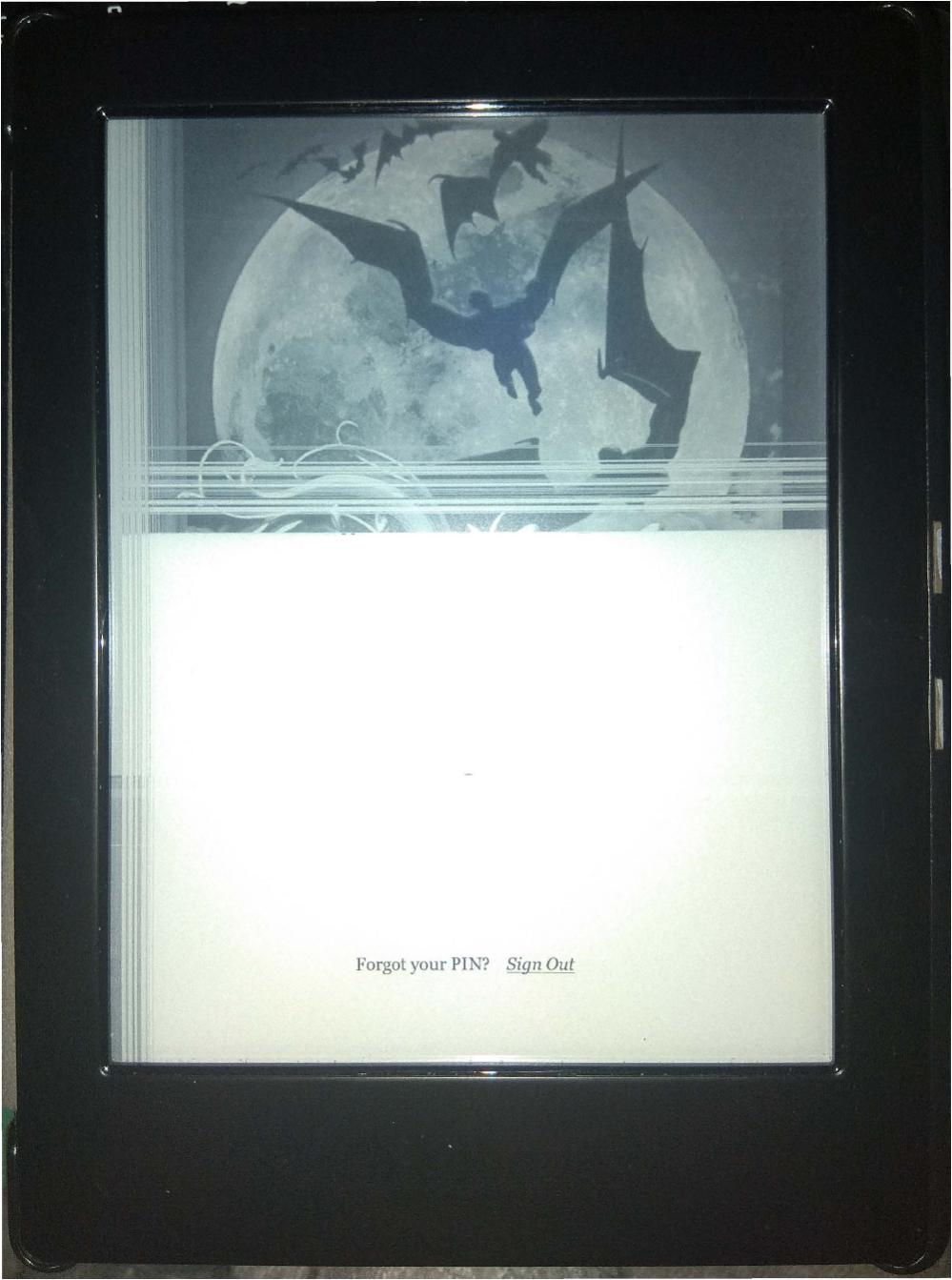

Hey everyone!
A sad thing happened yesterday: I was turning my Kobo Aura H2O on - everything seemed fine, the display seemed okay - and then the screen split! A big white strip separated the screen: the bottom half worked fine while the top half is frozen as if the screen was powered off or asleep.

Can you post a photo of the screen?
I'm sorry, I should have done that in the first place! It is attached to this post, now!
As you can see from the picture, I have the machine turned on, and I am able to interact with the bottom half of the screen; the blank rectangular that separates the display starts at the beginning of the "0" from the Locked Screen, and ends on the top half that is compeletly frozen. On a side note, the screen light seems to work alright.
Thank you for the help!

Open it - the front bezel is glued on, you have to pry it off carefully. Note the bezel must not be damaged, since its essential for touch screen functionality (the shiny parts is for infrared optics).
Then you need a small philips screwdriver to take the back plate off, and the mainboard itself.
(If you don't have any tools, search for a precision screwdriver set or a phone repair kit or sth., although phones might have even smaller screws than ereaders...)
Display has two connectors (display + frontlight), the slots they sit in have latches/hinges to hold the cable in place, so to remove the cable you have to find out how to lift the latch w/o breaking it.
Exact type of display should then be labeled on the display cable.
You're ready to order replacement when you've reached that point.
Don't remove the old display itself until the replacement arrived, it's glued on too and unless the new display has its own glue strips, you don't want those to collect dust. Also double check if it's same size / type same cable - they're called flex cables but they're not flexible at all, and tear easily, so the cable has to be made to reach the connector in the right place etc. if you got the wrong part no point in trying to use it.
Take pictures as you go so you'll know how everything was positioned. If the display is not aligned correctly and anything pushes on it, it'll just break again.

If the touchscreen still works, you should be able to make a connection, just have to (blindly) hit the [Connect] button in the [Cancel] [Connect] dialog. Might take a few tries (from screen center downwards) but should work.

Since I can't move from the Locked Screen, even though I try to blindly press the password keys, I assume I won't be able to connect my machine as I normally do.

Oh, Pin lock? You'd have to enter that blindly too... difficulty intensifies.
Once you have it open you could just put the internal SD card into a PC cardreader and dump the partition #3 (#1 is kobo OS and #2 is kobo recovery, #3 is user data)

Well, I'm happy to inform that I was able to bypass the Pin Lock by entering the numbers blindly! You can't imagine my screech as I saw the bottom half of the screen light up with the front menu, HUZZAH!
