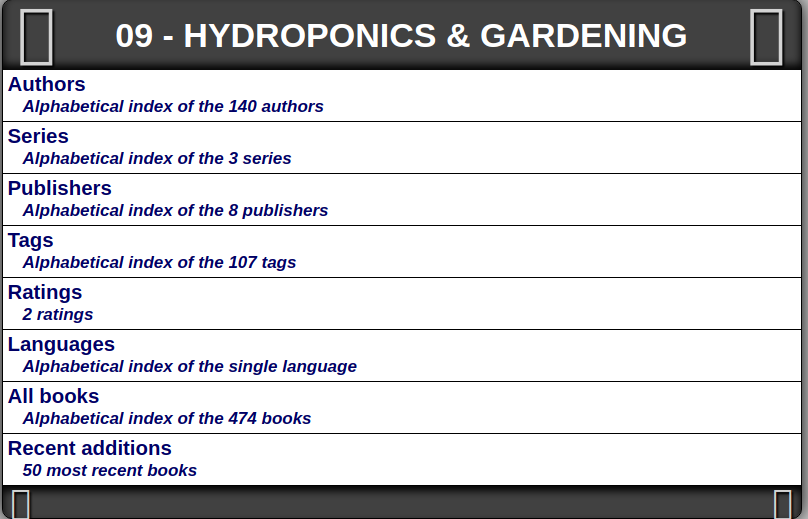

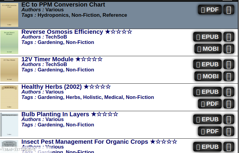

Question V1.1.3 Menu Icons?
Hola to All,
It's been a long while since I have posted, as COPS 1.1.1 has been running great for a very long time on my QNAP box.
So thought it time to get with the program...so to speak! Went to Github and downloaded the latest, expecting 1.1.2 but got what the docs say is 1.1.3.
Made a backup of current /share/Web/cops111 folder, unzipped the new version and copied in total to replace all current files. Then I copied the old config_local.php back into the cops111 folder (haven't renamed the folder yet...) and then fired it up.
Everything seems to be working as normal EXCEPT the menu icons do not contain any detail. They are just outlined squares or other shapes, but no description text or graphics in them.
This is the same no matter if I use Firefox or Chrome to access COPS. The icons do work, it if I click on them. I have attached some screen shots to show the details.
Monty
ID:	170478   Click image for larger version
MontyJ is offline   Reply With Quote
Old 03-30-2019, 07:40 PM   #1694
mariosipad
mariosipad is clearly one to watchmariosipad is clearly one to watchmariosipad is clearly one to watchmariosipad is clearly one to watchmariosipad is clearly one to watchmariosipad is clearly one to watchmariosipad is clearly one to watchmariosipad is clearly one to watchmariosipad is clearly one to watchmariosipad is clearly one to watchmariosipad is clearly one to watch
Posts: 726
Karma: 10738
Join Date: Nov 2012
Device: iPad & iPhone with Marvin 2 + 3 & Kobo Glo HD
Your (new) installation of cops is unable to find the new fonts (Font awesome Free) cops uses since version 1.1.2.
Can you check if you have these fonts in /Share/Web/cops111/templates/default/webfonts ?
Maybe you needed to clear your browser caches to make the (new) font work?
mariosipad is offline   Reply With Quote
Old 03-30-2019, 08:02 PM   #1695
MontyJ
MontyJ began at the beginning.
Posts: 224
Join Date: Jul 2012
Thanks Mario!
I cleared the caches but that did not chang anything. Here is the list of files in the .../webfonts folder:
-rw-rw-r-- 1 monty monty 133140 Mar 30 09:41 fa-solid-900.eot
-rw-rw-r-- 1 monty monty 488395 Mar 30 09:41 fa-solid-900.svg
-rw-rw-r-- 1 monty monty 132920 Mar 30 09:41 fa-solid-900.ttf
-rw-rw-r-- 1 monty monty 63836 Mar 30 09:41 fa-solid-900.woff
-rw-rw-r-- 1 monty monty 50372 Mar 30 09:41 fa-solid-900.woff2
