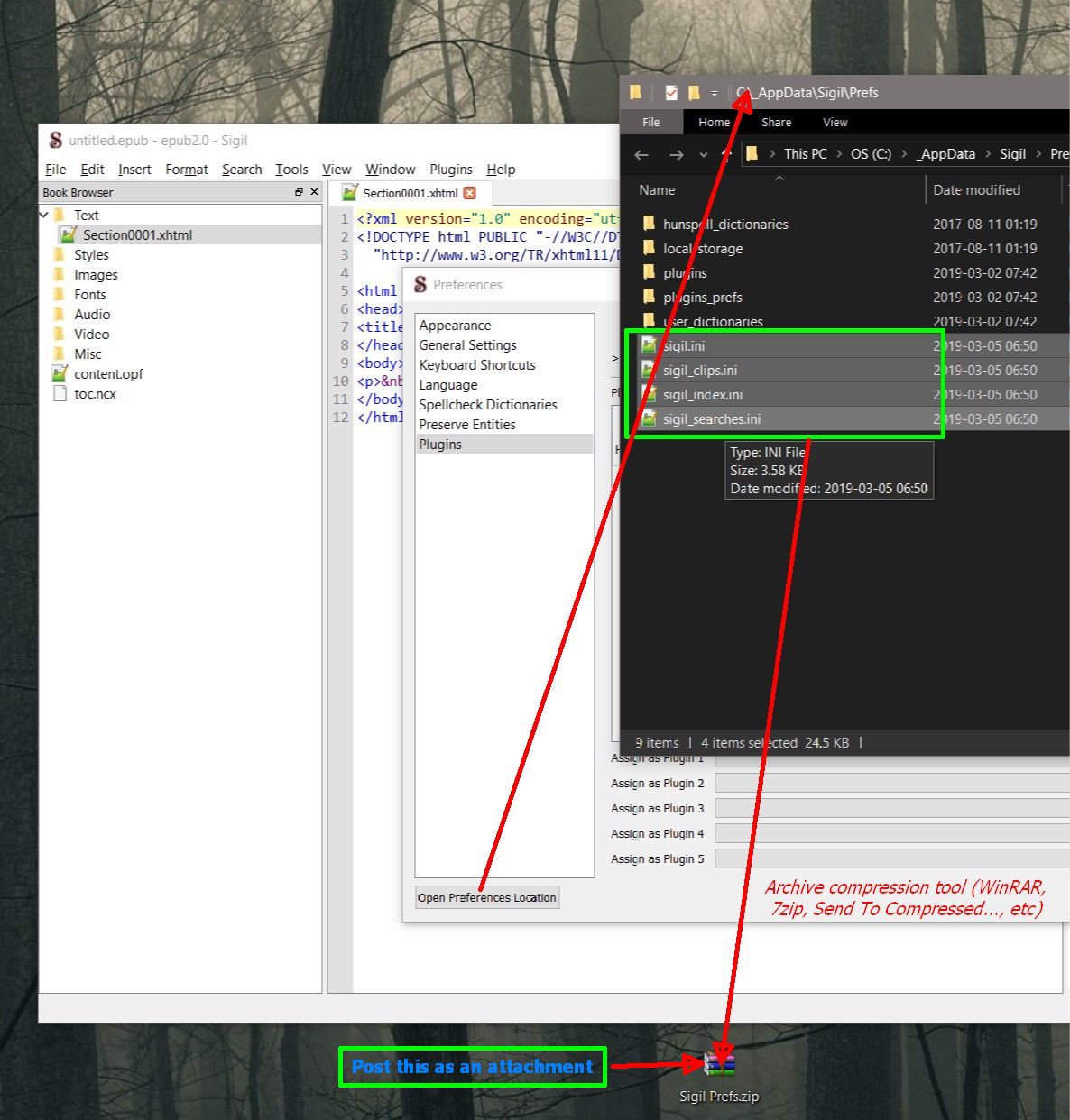

You can be of a lot more help. As soon as Sigil starts behaving badly in the manner described, please zip up your ini files in the preferences folder and post them so we can look at them. No one has yet complied with our request to post their ini files when a clean install of Sigil 0.9.12 starts badly misbehaving.
In case someone needs it:
Attachment 170007
Thanks!

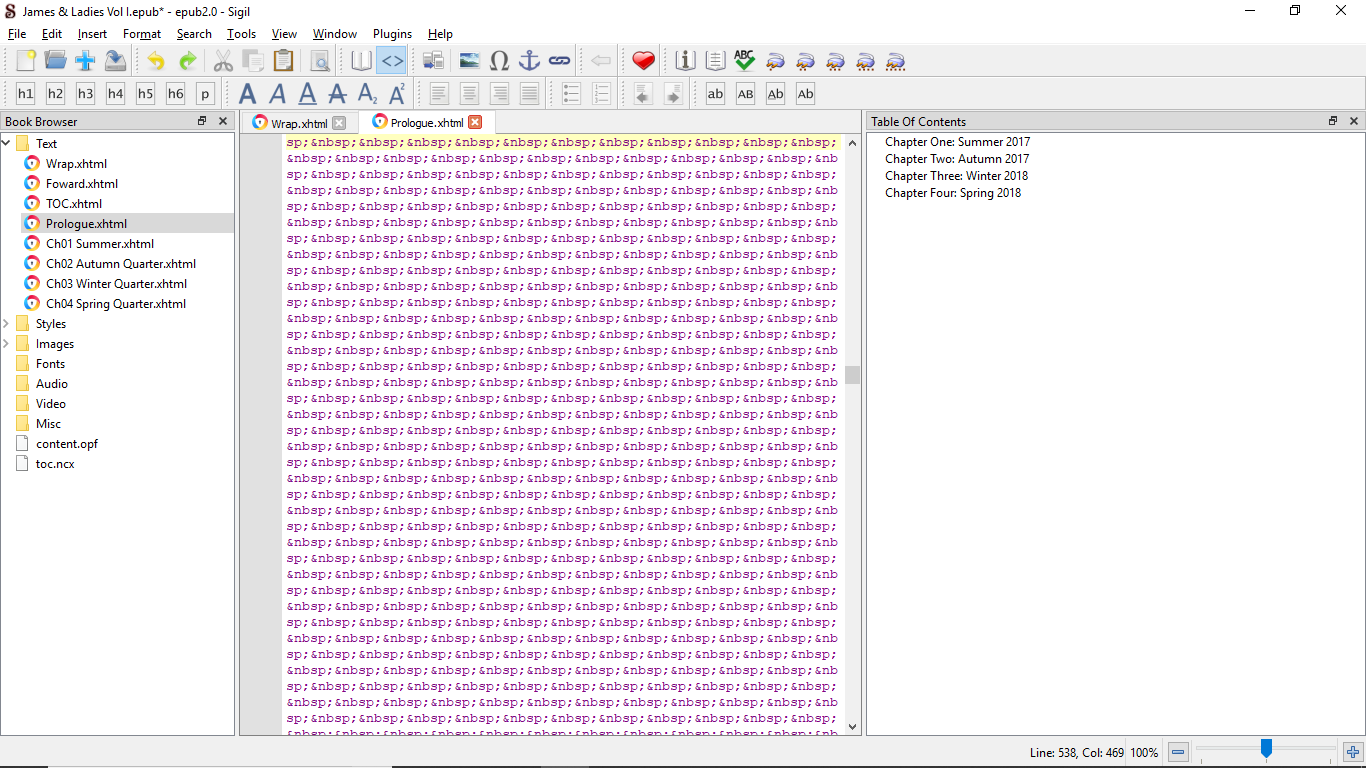

I just reopened my file and found &nbsp repeated hundreds of times at the end of some of my sentences. (see attached image)
This has not slowed down the performance of my computer, but make my creates odd spacing of sentences.

Yes, those repeated entities are from a broken xml lib that constantly duplicates all enties each time the file is loaded into CodeView or BookView.
That incorrect libxml was part of an old installer. See this post from earlier in this thread:
https://www.mobileread.com/forums/sh...1&postcount=10
I know DiapDealer fixed the libxml that was part of Sigil 0.9.12 installer for Windows but I do not know if he also fixed the libxml in the Sigil 0.9.11 release.
