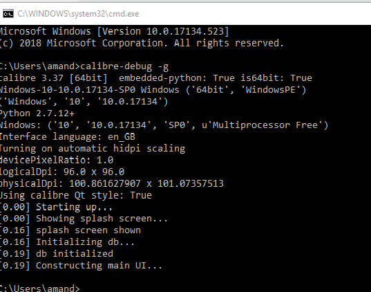

ok so I have a 2 prong answer for you!
1) I followed the directions, I deleted everything, went offline turned off AVG etc, and still it failed so I took the screenshots as the FAQ suggested
It still failed, so having read through the FAQ one of the things I noticed was it suggested trying the windows and not the Windows 64 bit version, and what do you know!! It is working!!
Interested to know if any of you geniuses can tell me WHY the 64 bit version failed?
Thanks to all for the help, so very much appreciated!

Name:	screenshot calibre.png

Marzi as per my reply just now, if you were using the 64 bit version try using the windows version, it has worked for me!
If we knew that we could probably implement an internal workaround My impression is that it happens more often in Win 7 than Win 10 - but it has been very occasional. As the FAQ says its probably due to some security issue, but what that is we've never discovered.
