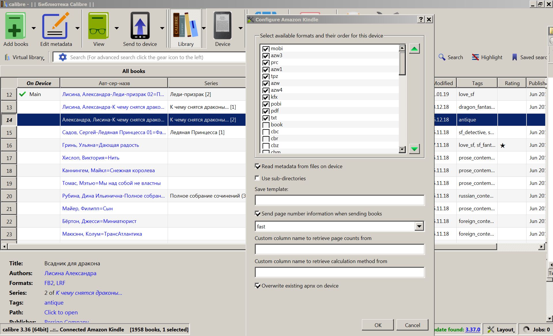

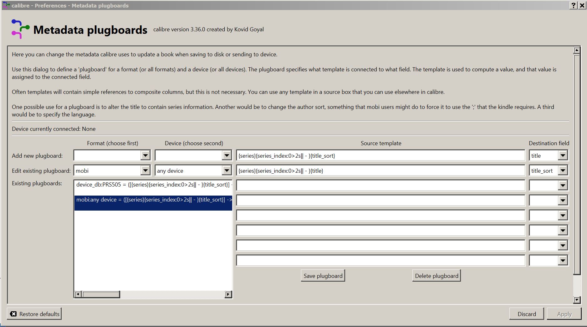

You probably used the Plugboard to achieve that.
Yes you're right I used Plugboard. (see Plugboard.JPG)
I think that if you Put the same, template into the device manager (when connected), that will work..
If I understand correctly, Device Manager is called: Device--Configure this device
Then I need to choose the desired format, let mobi. (see config_dev.JPG)
What's next?
The only suitable input field = Save template, but it looks somehow doubtful...
And if so, what expression should I make?
In my plugboard two lines......
{series}{series_index:0>2s|| - }{title_sort} == > title
{series}{series_index:0>2s|| - }{title} == > title_sort
Thanks for the tips
ID:	168828   Click image for larger version

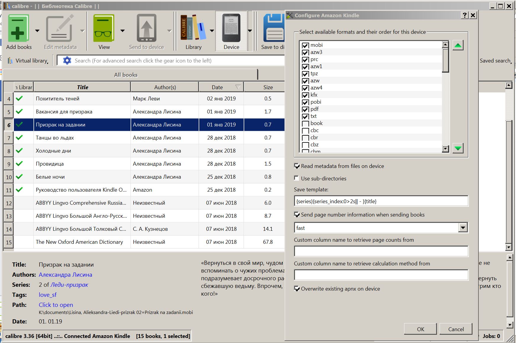

You put everything in the template you want the FILENAME to read (but not the extension part)
eg.
Thanks for the tips...

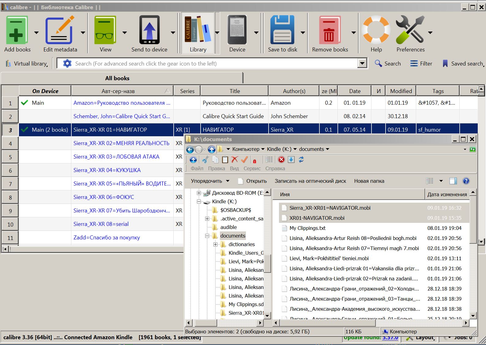

Unfortunately, this attempt was unsuccessful (see picture D_sav_t)
It appears that this field (save template) is responsible for representing the name of the file to be written to the file system on the e-book, rather than displaying the name from the e-book in Calibre.
See picture F_sav_t:
1) save template == {series}{series_index:0>2s||-}{title}
XR01-NAVIGATOR.mobi
2) save template == {author_sort}{series:|-|}{series_index:0>2s}={title}
Sierra_XR-XR01=NAVIGATOR.mobi

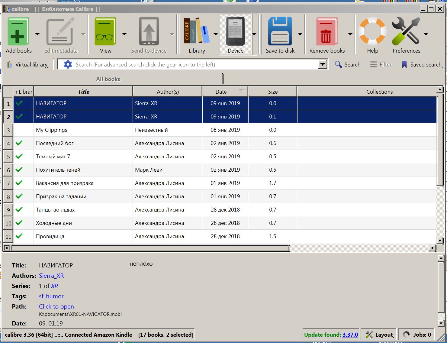

On Device( e-book ) See picture dev:
ID:	168957   Click image for larger version
ID:	168958   Click image for larger version
