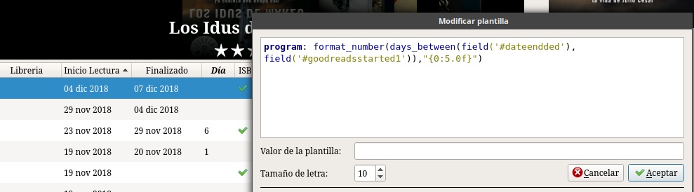

I have changed the format so that I do not get the result in decimals with this syntax:
program: format_number (days_between (field ('#dateendded'), field ('# goodreadsstarted1')), "{0: 5.0f}")
I must revise, similarly because with some dates it does not calculate me and they are loaded in the same way.

Old 12-12-2018, 01:04 AM   #10
davidfor
Posts: 24,905
Karma: 47303826
Location: Sydney, Australia
@chaley
@davidfor
I am reading your comments carefully.
Thanks to run with the word program. It has been overlooked. several eyes see better than two.
Sorry, I don't know what is happening there. The two things I'd try would be restarting calibre or editing one of the dates.
Also use "raw_field" instead of "field", just in case the dates are formatting in a way that calibre cannot handle.
