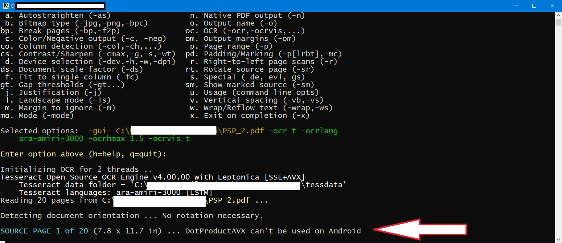

Dear willus
thanks for help it worked now... thats is great...
Please note that I try to run the ocr but the program close as it start to use the tesseract ... (I try with/without GUI) and I try 64-32 and the old cpu versions
please find attachment of the cmd error that I get before it close.
regards
