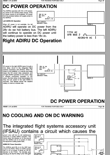

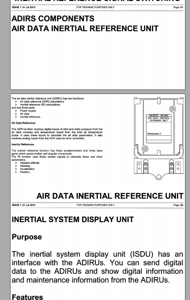

How to fix these small sentences
It would help if you could post the source or PM me the source PDF file.
Any kind of intelligent formatting that k2pdfopt tries to do will likely not be very successful because of how diverse your source PDF is (some pages are 2 columns, some are not, and lots of pages have specially positioned text relative to a figure), so I'd recommend just a straight cropping of every page into 2 pages (2 columns) using the grid option, even when it will cut a figure in half:
k2pdfopt -grid 2x1 sourcefile.pdf
