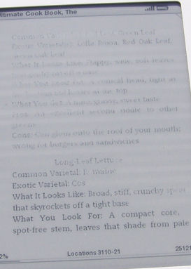

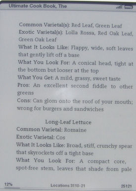

Hey guys,
Imagine the horror when I turned on my Kindle 2 while walking downtown today and the screen immediately faded and turned blotchy from the sun hitting it! Is this normal? I thought that the Kindle could be read in direct sunlight and this is only weak spring strength sunlight!
So what we have here is whenever the screen is refreshed by page turning and it's in direct sunlight, the text is washed out. But step into the shade and turn a page forward or back, and then back to the original page, it comes up fine. Although I do note some letters may be a little distorted but a pixel or two. See attached photos to view this phenomenon.

Originally Posted by MsAstoria View Post
Hey guys,
I saw a posting on the same thing from another K2 owner on Amazon forum, so should I call tech support
So second call to Amazon support got me a new Kindle to be sent to replace this one. It's obviously defective and the gal was very nice and handled the situation well. Seems they have had a few K2's being returned with this same issue. So, new K2 owners, be sure and check your Kindle out in direct sunlight before you start loading it up with all your MP3's and doc, urls. Guess I will be copying my urls to my main computer or maybe I can just cope the document folder in K2 Drive? Does that work? Hmm, good thing all Amazon purchases are backed up on Amazon.com and I will just have to put back on my FreeBooks and other freebies on the new unit. Just a minor inconvenience.
