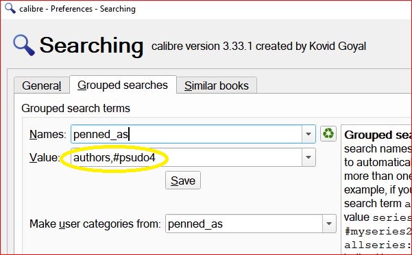

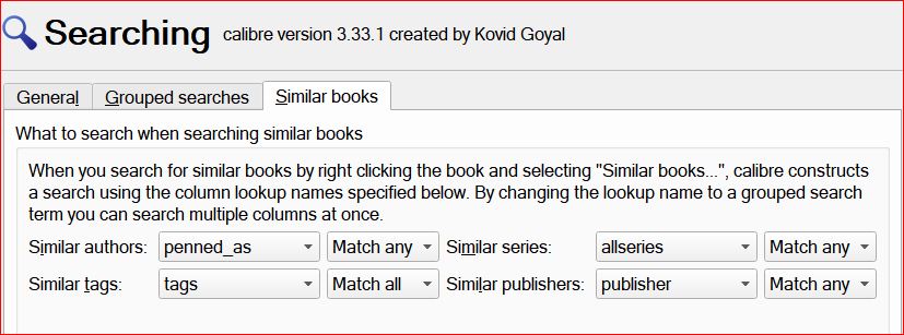

FWIW
I put the 'on the cover author, in Authors and the real author in#pseudo4 (I hate to type long winded names )
Exception #1: I standardize the Author name (eg Christopher Nuttall - Christopher G. Nuttall) in either pace
Exception #2 I put the books Editors (when it appears on cover or forward) name in Authors and the list of writers in #pseudo4. This keeps the filename from the SendTo template, tame
Be sure to modify Preferences: Searching: Similar Books (tab) and Grouped Searches (tab)
Name:	Similar Books.JPG
ID:	167147   Click image for larger version
Name:	Grouped Search.JPG
Is the #psudo4 in the second image a typo?
Old 10-24-2018, 12:34 PM   #12
Posts: 31,454
Karma: 62503914
No, that is my Author like field name, penned_as is the combined name (appears in the Tag browser, is a search field value, and is what pressing Alt A calls)

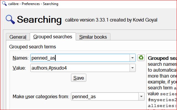

Old 10-24-2018, 11:07 PM   #13
Posts: 49,961
Karma: 178398936
What I was referring to was the value field where you have "authors, #psudo4". I was wondering if the #psudo4 was correct or if it was a typo and should have been #pseudo4?
Old 10-24-2018, 11:37 PM   #14
Posts: 31,454
Karma: 62503914
same typo in both places
