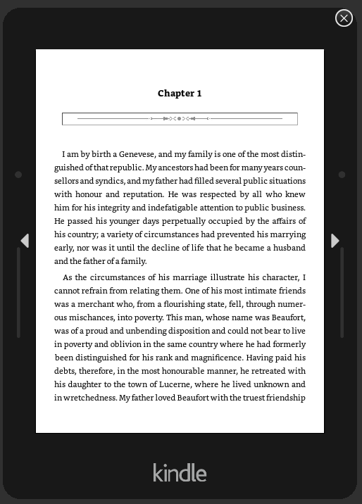

For testing, I used the ebook you sent for the example on the plugin post (Mary Shelley's Frankenstein).
I'm sending the modified ePub, including the <hr> elements. I can't send the KFX file, since the forum doesn't allow this kind of file. The rules were inserted below each Letter/Chapter title.
To help visualizing the problem, I also sent the printscreens of both ePub and KFX files.

Device: Kindles
Originally Posted by thiago.eec View Post
For testing, I used the ebook you sent for the example on the plugin post (Mary Shelley's Frankenstein)...
Thanks! That was great. I can see that the problem is that calibre’s conversion pipeline rewrites the CSS for the border in a way that is unacceptable to the Kindle Previewer.
A workaround is to use the command line interface to the plugin, which will bypass any alteration of the EPUB by calibre, preventing the problem.
I will try to come up with a better solution for the next plugin release.

I did as you suggested and used the command line interface. It did the job avoiding the borders, altough one last problem remains: it is altering the gif image.
When I visualize the KFX (azw8) on KindlePreviewer (see the attached screenshot), it looks perfect, just like the ePub. But, when I sideload it to the device, on the Kindle Paperwhite screen, the gif has a gray background (see the screenshot attached). This gif is supposed to be tranparent. It shows properly on the device when I use AZW3 format, or when I convert it using KindlePreviewer directly (altough it will save on MOBI format).
How can I configure the convertion so it doesn't touch the images? Through Calibre, I used your suggestion to change the output page configuration to "Tablet", but it still causes the gray background.
The Amazon Kindle Publishing Guidelines explicitly state that image transparency is not supported, even though it does work in many cases.
When producing KFX format the Kindle Previewer converts all images to JPEG format causing transparency to be lost. You cannot prevent this.
The transparent background should be made white in the process, not gray. That is the case when I convert the modified Frankenstein book that you attached earlier in this thread.
If you attach your sample that instead shows a gray background when sideloaded then I will try to determine why it is not working as expected. I was able to reproduce the problem using the book you uploaded previously and I am looking into it.

I tried the book in KFX format on a Kindle Oasis and the gray rectangle was present as you showed. I also sideloaded it to the Kindle for Android app and Kindle for PC. Both of those showed it correctly, without the gray rectangle. So it appears to be a problem specific to e-ink Kindles.
As far as I can tell, in KFX format on an e-ink Kindle an <hr> is rendered with an implicit gray background color. It can be made darker, but not lighter.
Changing the EPUB so that the image is rendered using a <div> instead of <hr> causes it to work properly even on the Oasis. I don't have a work-around other than making this change.
(Thanks for the learning experience.)

Thank you very much for the effort and patience, since this is just a minor e very specific problem.
With your guidance, I think I got a solution.
As I was doing some more testing with another image (wich has a white background), I came to realize that the problem was never the images. The problem is with <hr>, like you also figured. More specificaly, the problem lies on the <hr> element background color.
So, I supressed the color hex code (#FFFFFF) and it just solved the problem!
Go figure... It seems that white (#FFFFFF) shows up as a light gray on e-ink screens, or something like that.
See the attached modified Shelly's book (KFX inside the RAR). It now renders correctly on my Kindle Paperwhite, which made me very happy.
