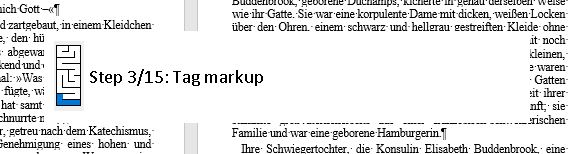

Hi
after a longer pause with epub editing (2 months) I started some new projects last Monday. Most of them are pdf ebooks which I load directly into Word (MS Office 365 V1808) for conversion. After some basic corrections I usually start Postprocess OCR. Currently this module runs into step 3/15 (tag markup) then crashes Word, repeatedly. Tried different pdf and also plain docx files. Same story.
Nothing changed during the recent 2 months except for some updates of Word. I did not touch the ePubTools.
All other functions (e.g. search/replace or epub import) are working perfectly!
Anyone with such problems here around?
Klaus

Well, yesterday I did a book myself and had issues in that department as well. I also got a report from someone else. I am not quite sure why yet, as this does not happen on older version of Word. They did make a change, but it is not clear what it is and it is also not consistent. I am looking into it though.

I can confirm there is something broken in at least the latest version of Word (Office 365) in the search and replace engine of Word itself. I can repeat the observed behavior manually. Unfortunately this cannot be fixed by me of course. I did think of a way to circumvent this, but it will have a performance impact and I need time to program it as well.
I will post updates every now and then.

Sure I can explain more. If you for example do the following search:
Find: empty
Find formatting: italic
Replace: [dummy]^&[/dummy]
Replace formatting: non italic
If you now do a S&R, it should just set the dummy tags before and after the italic part and also remove the italic formatting. That is how it should be and always was. However, now the tags are placed at the correct place, but not everything is set to non-italic (including the end-tag!). That causes the same part of the block (including tag) to be selected again, and again, and again. That is not how it should work and this was recently introduced. I do expect it to be solved soon, as this is clearly an issue in Word itself as I can reproduce it manually.

It is absolutely related to Klaus' OCR PP problem. It is actually doing that to tag the formatting in that step. As not all the text is de-formatted, it is again selected and tagged and again, again, etc. So, it appears to hang. If you wait long enough, it will end, but you will have a big mess with half tags all over. I actually had the same problem myself as well as someone else I know. I am not too optimistic that MS will solve this soon, they have the most atrocious bug reporting system I know and you actually needs votes to have your bug handled sooner or so it seems.
Hence, I am thinking of an alternative method. I have designed one, but it will require some time to program and test. I hope to start tomorrow evening.
