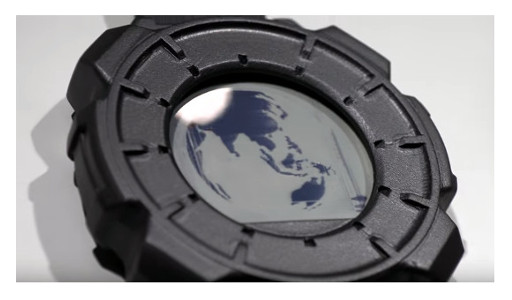

I took a screenshot of the small B/W display. Should be seen in the real world and the right lighting... Indoors, through the camera, to me the effect looks very similar to E-Ink's EPD.
Old 06-04-2018, 07:24 AM   #53
pdurrant
The Grand Mouse 高貴的老鼠
pdurrant's Avatar
Posts: 74,535
Karma: 318090012
Location: Norfolk, England
Device: Kindle Oasis
Originally Posted by mdp View Post
The displays can feature frontlight - in a customized implementation forced by the technology, but twice as efficient as the usual one.
I suspect they're saying the frontlight is twice as efficient as E-Ink's because they have twice the reflectance from the display. So to get as bright a display as EInk they need only half the frontlight power as EInk.
