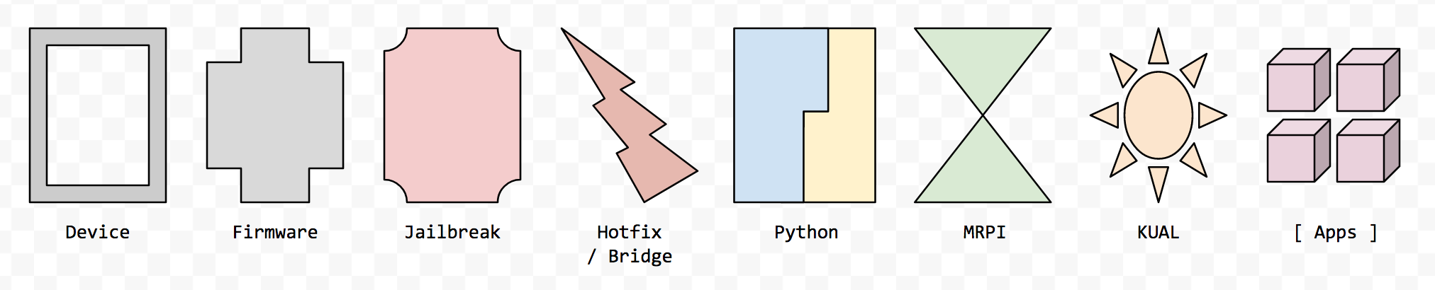

I'm thinking of making a diagram—software hackitecture diagram heh—of the "stack". Am I missing anything? (see attachment)
