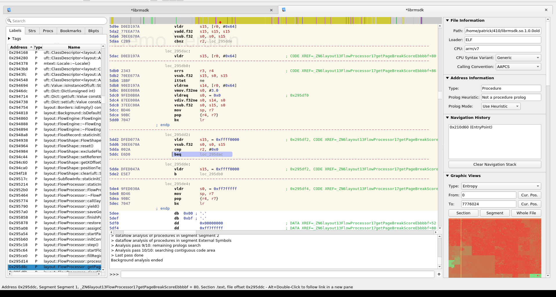

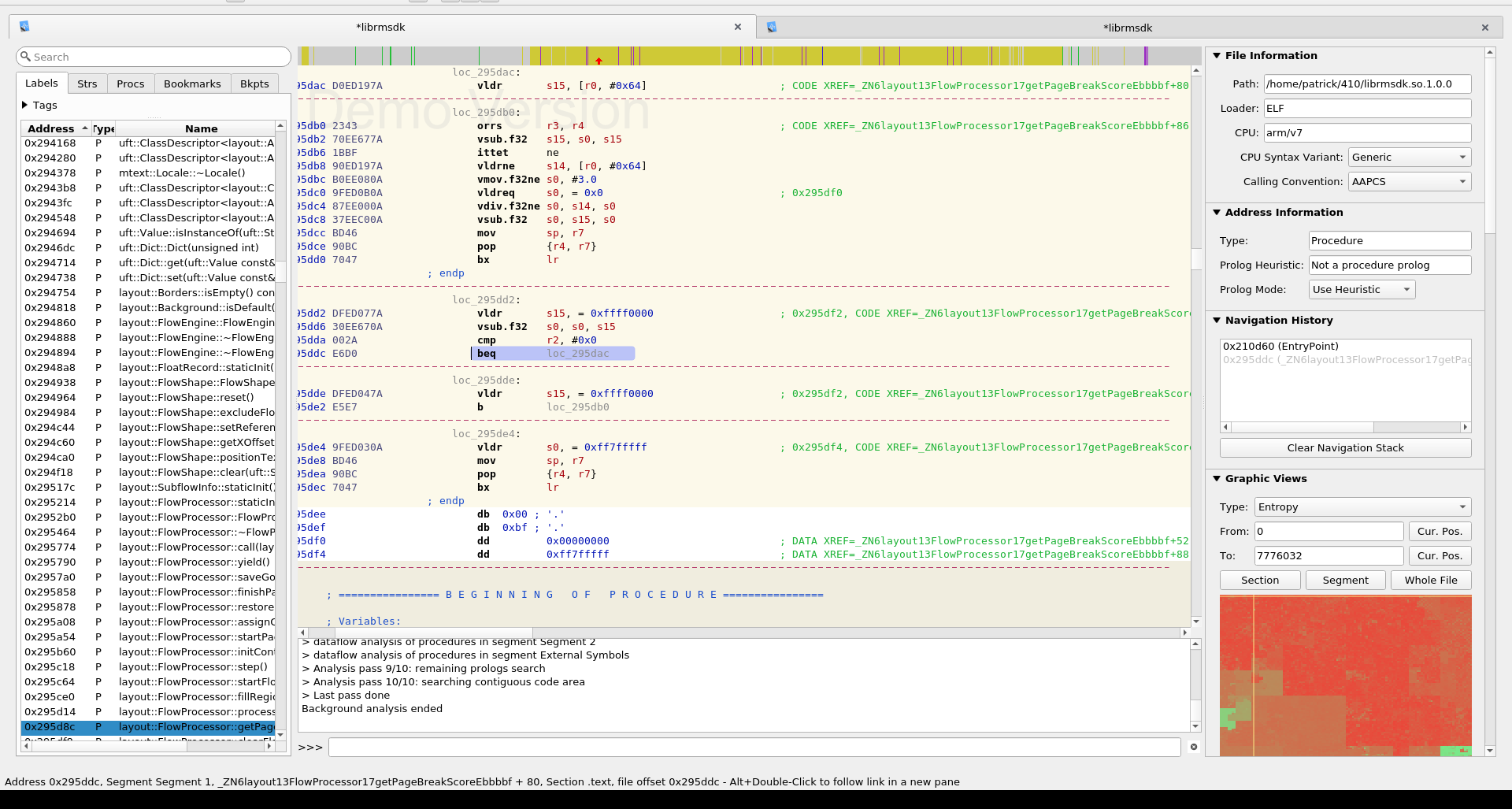

Do you know which patch? I tested all of them and they worked fine. It might be the "Orphans/widows avoidance" patch (which is the most likely to have caused issues as it is the shortest and least tested, but it seems unlikely as they haven't changed much, see the screenshots). There is also a possibility it might be the new line spacing patches GeoffR provided, as I haven't tested them, and they are quite different compared to the previous version. I'll test this more tomorrow.
ID:	165838   Click image for larger version
