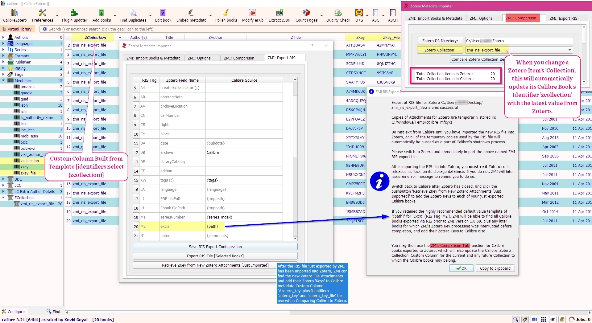

Version 1.0.58 New: Add the Zotero Key to each just-exported Calibre book
Version 1.0.58 - 2018-04-11 New: Add the Zotero Key to each just-exported Calibre book after its import into Zotero so that the ZMI:Comparison Tab functionality may be used for both books imported from Zotero and Zotero books imported from Calibre.
See the attached example with ToolTips that explain the process.

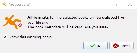

I have one question: Is there a possibility to have the original files just in one directory. I use to markup the files and don't want to have them double (one being in the Zotero file directory and one being in the calibre directory)...

Select All Books > Right Click Mouse > Remove Books > Remove All Formats from Selected Books. See the attached image.
