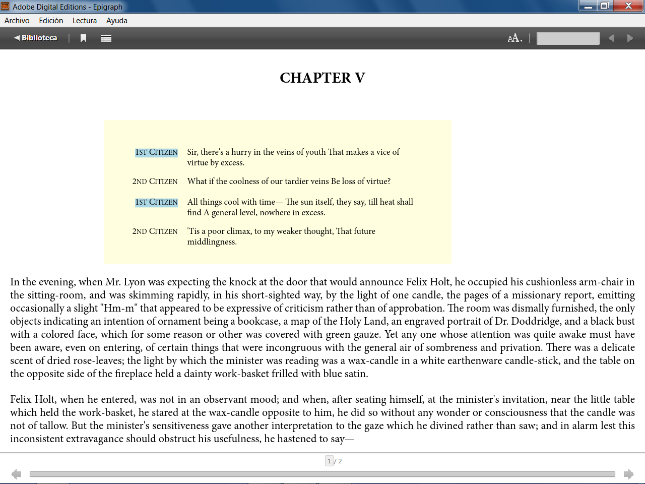

Hi Alex;
If you are going to use a table, then there is not a best solution than the Turtle91's. But if you want to try another aproximation (with just <p> tags) then you could watch the epub I attach. And below you can see a screenshot of ADE:
The solution should also works for Kindle.

Hmmm, use a table. The method I posted will work for ereaders based on RMSDK (ADE) and WebKit but won't work on old Kindle devices (K1/K2/KDX). So, use a table but even simpler than the posted by Turtle. For example:
1. In your .xhtml file:
  <table>
    <tbody>
      <tr>
        <td>
          <span class="lb">1<span class="sc">ST</span>&nbsp;C<span class="sc">ITIZEN</span></span>
        </td>
        <td>
          Sir, there's a hurry in the veins of youth
          That makes a vice of virtue by excess.
        </td>
      </tr>
      <tr>
        <td>
          2<span class="sc">ND</span>&nbsp;C<span class="sc">ITIZEN</span>
        </td>
        <td>
          What if the coolness of our tardier veins
          Be loss of virtue?
        </td>
      </tr>
      <tr>
        <td>
        </td>
        <td>
          All things cool with time— The sun itself, they say, till heat shall find           A general level, nowhere in excess.
        </td>
      </tr>
      <tr>
        <td>
        </td>
        <td>
          'Tis a poor climax, to my weaker thought,
          That future middlingness.
        </td>
      </tr>
    </tbody>
  </table>
2. And in your .css file:
table {
    width: 90%;
    margin: 2em 5%;
    border-collapse: collapse;
    font-size: 0.9em;
td {
    vertical-align: top;
    padding: 5px 10px;
    font-family: serif;
.sc {
    font-size: 0.7em;
.lb {
    background-color: lightblue;
Aclarations:
1. Don't give a width to columns, just give a width to the table. Of that way, the column width will be given by the text inside the cell.
2. In the first column, use a non-break-space to separate "1st/2nd" of "Citizen" (of that way the width of the first column will be always optimal).
3. Don't use the property "text-transform: smallcaps;"; instead, use "fake" smallcaps.
4. Of course, you can play with the width of the table, margins (for the table), paddings and font-size. Remember that margin-left and margin-right are linked with the width of the table (you can't have a table with a width of 90% of the screen and margin-left/right of 15% each).
I attach an epub so you can understand the things better than with my words.
Regards
Rubén

I've long since given up trying to duplicate the printed version. It's just not possible or, IMO, desirable.
THIS!!! A thousand times, THIS!^^^^
The best I can do with current CSS functions is specify where a line breaks and use hanging indents for any reflowed portions.
*shrug*
edit: Or you could set the epigraph/image on it's own page and use an SVG wrapper.

Hi:
I'm not going to lie--I stayed out of this discussion because I wasn't clear on what you were really trying to do; initially, it seemed that you wanted lines to NOT break at all, on larger eReaders (although how you'd do that in a world of fonts that can be resized, I don't know), but break on smaller--but now you're saying that you wanted the lines to break "in a standard way." What does that mean?
Hitch
Thanks for your response, and please accept my apologies for not being clear. What I meant was to have each line of the poem break at the right edge of the screen if it is too long for the width of the screen, and to continue with a 2em indent on the screen line below. The 2em indent of course is to show that the words are continuations of the line above, and not a new line of the poem.
It's quite easy to do with most poetry, even when a given line of poetry is itself indented a space or two. But I found it impossible to do on a six inch screen when the whole 'verse' is indented and preceded by a character name as on the epigraph I attached. It might have worked on an iPad screen, but I wanted it to work on a 6" reader and a Samsung tablet as well.
AlexBell is offline   Reply With Quote
Old 08-12-2018, 09:57 PM   #15
AlexBell
AlexBell ought to be getting tired of karma fortunes by now.AlexBell ought to be getting tired of karma fortunes by now.AlexBell ought to be getting tired of karma fortunes by now.AlexBell ought to be getting tired of karma fortunes by now.AlexBell ought to be getting tired of karma fortunes by now.AlexBell ought to be getting tired of karma fortunes by now.AlexBell ought to be getting tired of karma fortunes by now.AlexBell ought to be getting tired of karma fortunes by now.AlexBell ought to be getting tired of karma fortunes by now.AlexBell ought to be getting tired of karma fortunes by now.AlexBell ought to be getting tired of karma fortunes by now.
AlexBell's Avatar
Posts: 3,413
Karma: 13369310
Join Date: May 2008
Location: Launceston, Tasmania
Device: Sony PRS T3, Kobo Glo, Kindle Touch, iPad, Samsung SB 2 tablet
I entirely agree. But I have been the recipient of flak in the past for not duplicating the text even where the meaning of the English words has changed.
For example, in my opinion, the phrase 'some gay young men' in the 21st century means something quite different than when it was written in the 17th or18th centuries. Should I have left it as written by the 19th century author even though it was clearly not what she meant in her time?
