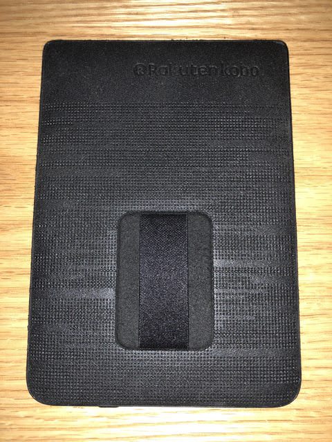

plastidip
just did the plastidip mod, decided to do both the back and the front.. loving how grippy it is now, thanks again for the tip!
I already had the nobiggi strap applied before I did the plastidip so I had to mask that off with painter's tape beforehand. ended up doing 4 coats total, figured that was enough but considered getting some clear plastidip or even the glossifier to go on top as well.
