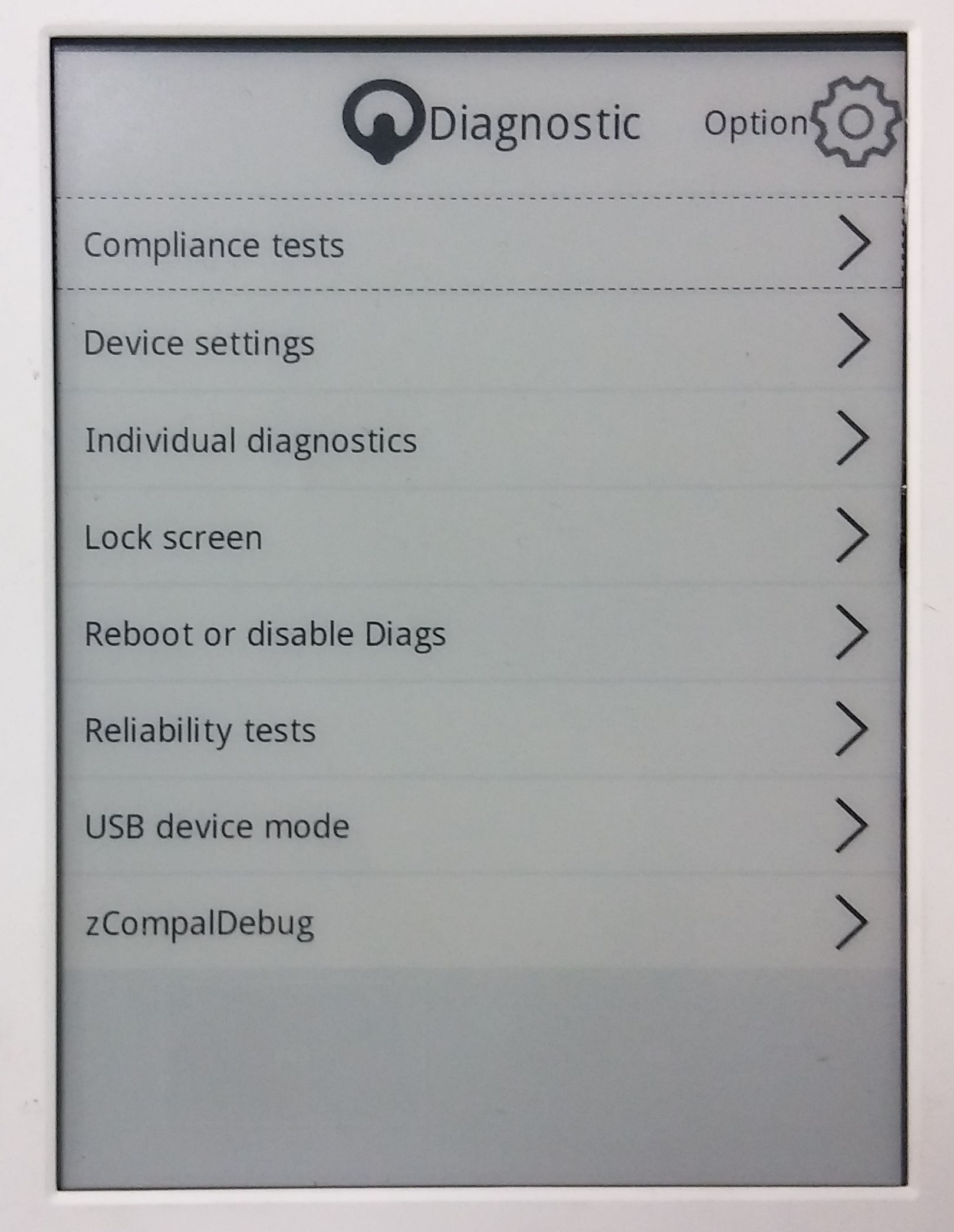

Hi, I have a KT3 in the new diagnostic mode. How do I get it out? If I click Reboot or disable Diags there is only the option to Reboot but not to disable Diags. Thanks!

And then the usual over an adb shell: idme -d --bootmode main && sync && reboot

I don't think it is going into adb mode. When I do what you said the screen flashes and says switching to ADB mode. But then it says Exit code:0
Maybe I just don't know what I am doing.
