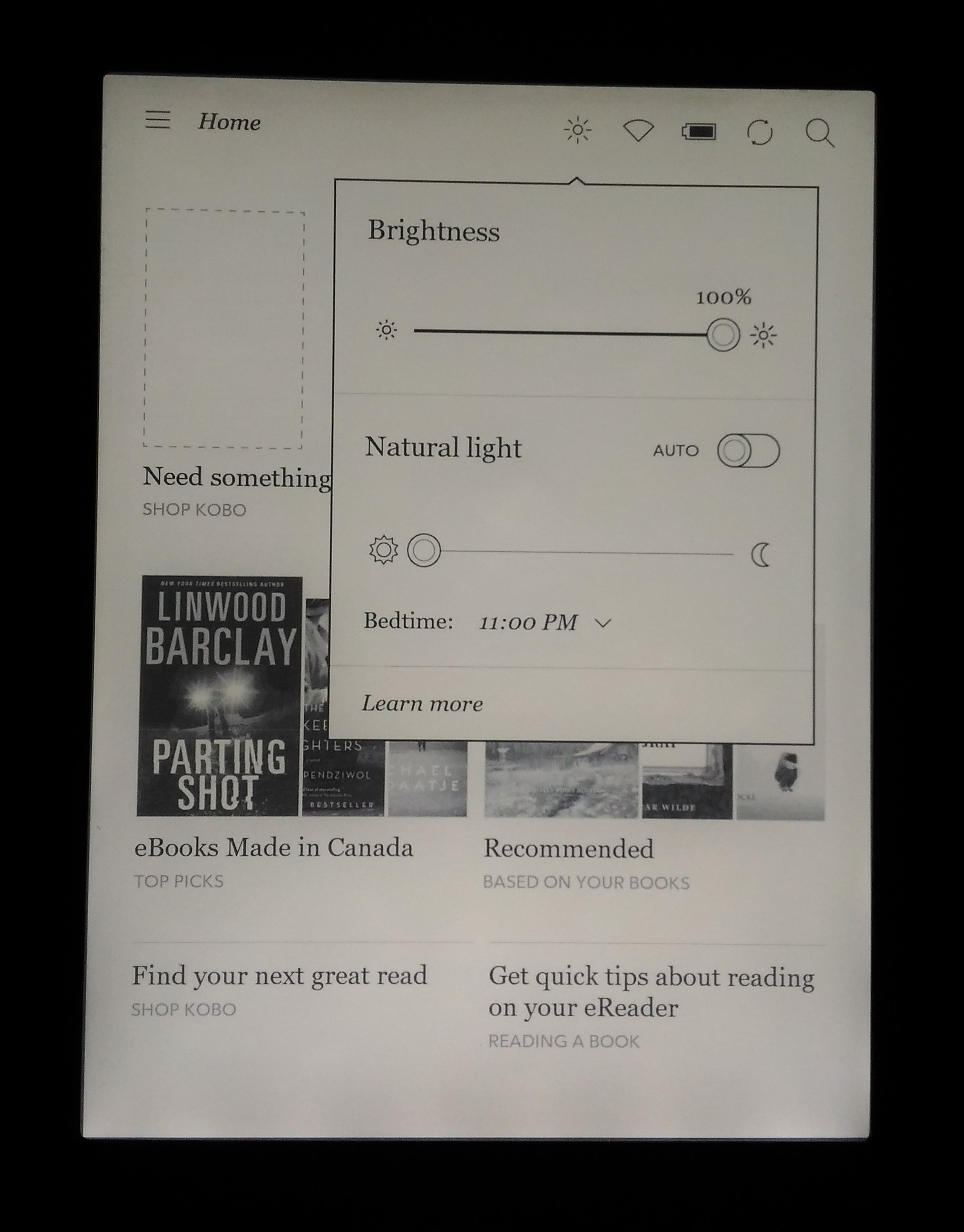

I discovered another way to get rid of the light bleed.
There was no need for the tape. All I did was touch up the side of the screen (not the surface but the little indentation on the side) with black marker where the bleeds were. The effect was immediate.
However "WARNING" it did make the screen DARKER specially when I first run the marker up and down the edge. Later I did remove most of it with alcohol. So I found out even trace amount of black gets rid of the leaks. This attached picture shows after I cleaned up the sides with alcohol which lighten up the screen.
It is still darker then original.
Please do not attempt this unless you can afford to brake your brand new e-reader. Be very careful. And I say again the screen gets DARKER and no amount of cleaning restores the original brightness.

Just to follow up.
Here is the final result after reassembling. Picture taken in complete darkness.
PS. My camera shows the picture darker. It is a lot whiter when I look at it.

Thank you for that!
[s]I must say the light bleed on your Clara pre-fix looks a LOT worse than the bleed on mine, I'm quite surprised at how bad it is to be honest.[/s] Ah I didn't realise the "before" picture was actually the "after" picture without the bezel.
I tried your first solution by squeezing my Clara's bezel where the bleed shows and I saw the bleed disappear completely! How satisfying! It did sneak back slowly while I continued reading but I might just try your idea of a more long term squeeze/weight to see if the adhesive sticks better for a longer time.
