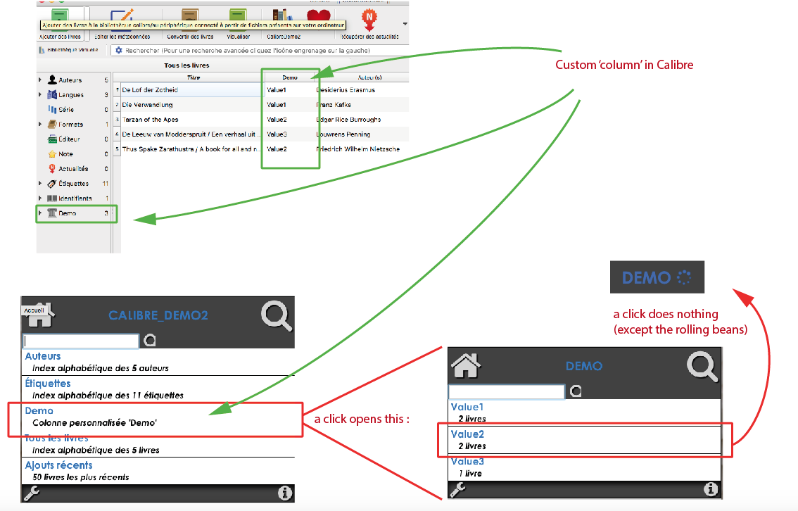

Following Mariosipad's advice, I created a small test database.
In this small database I created a custom column (called 'demo') and populated the field with various values : Value1 ; Value2 and Value3.
I have the same behavior as with my main database :
The custom field displays in the main window.
A click on the field opens a window with the correct page title, values and counts.
But a click on one of the values only get's the rolling beans next to the page title.
Also, the custom column title and values don't appear in the book preview as I understand they should.
So I assume there is something wrong with my COPS settings.
All my settings are now in the config_local.php file :
<?php
if (!isset($config))
$config = array();
$config['calibre_directory'] = array ("CalibreChG" => "/share/Multimedia/Calibre/", "Calibre_Demo" => "/share/Multimedia/CalibreDemo/", "Calibre_Demo2" => "/share/Multimedia/CalibreDemo2/");
$config['cops_title_default'] = "CaLibre";
$config['cops_subtitle_default'] = "Epub et PDF";
$config['cops_author_split_first_letter'] = '0';
$config['cops_titles_split_first_letter'] = '0';
$config['cops_calibre_custom_column'] = array ("collection", "demo");
$config['cops_calibre_custom_column_list'] = array ("collection", "demo");
$config['cops_calibre_custom_column_preview'] = array ("collection", "demo");
$config['cops_language'] = "frCHG";
$config['cops_use_url_rewriting'] = "1";
Please have a look at the screenshots attached.
Any clue where I should look into ?
Name:	COPS Custom Column issue.png
cgronier is offline   Reply With Quote

I don’t see anything wrong with your config_local.php. So I cannot reproduce your problem.
What version of php is the qnap using ./cops/checkconfig.php?
What version of calibre are you using (on macOS)?
What version of cops are you using?
Can you try on macOS (or windows or linux) with firefox instead of safari? (Safari/webkit should work on iOS)
mariosipad is offline   Reply With Quote

My version on php is : 5.6.63
My version of calibre (Mac OS) is 3.23.0 (latest AFAIK)
My version of COPS is 1.1.1 (copied form GitHub)
Reminder :
I have done some testing of my issue regarding the fact that I can't go beyond the summary page of a custom field (please refer to the picture I attached to post #1638)
Mac OS - LAN access - HTML - Safari : does not work (rolling beans)
Mac OS - LAN access - HTML - Google Chrome : does not work (rolling beans)
Mac OS - LAN access - HTML - Firefox : does not work (rolling beans)
iOS (iPhone/iPad) - LAN access - HTML - iOS browser : does not work (blank/gray page)
iOS (iPhone/iPad) - WAN access - HTML - iOS browser : does not work (blank/gray page)
but :
iOS (iPhone and iPad) - WAN access - FEED (http://[MYIP]/COPS/feed.php) - eBook Search app : WORKS !
So what do you think is going wrong ?

There is nothing, as far as I can understand and test, wrong with the versions of COPS, PHP and calibre.
Did you test with and without the password option working in .htaccess?
And did you (of course you did) restart/reboot your qnap?
And COPS works as expected if you do not use (click on) the custom columns?
The OPDS feed of COPS ( http://[MYIP]/COPS/feed.php ) works as far as I understand COPS through PHP and not apache.
If you use an OPDS enabled ebook reader on iOS that would fix your problem, but not if you want to use your Kobo webbrowser with COPS.
What I can advise is:
- make a new installation of COPS in a new directory on your Qnap (../cops2)
- start with copying config_default.php to config_local.php
- only add one calibre (test) database to config_local.php
> test if this works
- add $config['cops_calibre_custom_column'] = array ("demo");
> test if this works
- etc. if it works just keep adding line after line. If not
(maybe there is weird typo somewhere that neither of us sees .....)
The line $config['cops_subtitle_default'] = "Epub et PDF"; should have no effect in Apache.

Good news.
I applied the method suggested by Mariosipad and tested the settings step by step.
Well... all woks as expected in the end !
I have
- the multiple database view
- the custom language file (because I don't like the French name of Collection for the 'Series'
- the htaccess password
- and of course the custom column (and even a different custom column for two different databases), that can be clicked and is displayed across all screens
In the end I can't tell what when wrong as the settings of the test setting seem to be the same as for the non-working setting.
So far this can be put on the account that I can have messed up something, somewhere, without knowing. Which would not be a surprise due to my poor (no) knowledge of php.
But there is more to this.
In order to do the testing I created a new COPS folder, named differently than the original non-working (I.E. 'COPSTEST' vs 'COPS').
So 'COPSTEST' works as it should and 'COPS' has the non-working custom column issue.
After this testing I cleaned up the Web folder and renamed the non-working 'COPS' to 'COPS_OLD' and the working one to 'COPS'.
Surprisingly the one now called 'COPS' (which has the new setting) get's the problem !
And the one now called 'COPS_OLD' (which was for far having a problem) works properly !!
Which means that the name 'COPS' seems to be the cause of the problem...
I tried other names around and in the end, any name works, except 'COPS'.
Of course I blamed the browser caches and tested the issue with different browsers, clearing the caches each time.
I even tested this on my wife's PC that has never been connected to the server.
I can reproduce the problem each time.
In the end, I can live with a folder named anything except 'COPS', but I would like to understand why the name of the 'COPS' folder can create this problem.
Finally, warm thanks to Mariosipad for having put me on the path of the troubleshooting process.

That certainly is a very strange "problem". One that I cannot reproduce. I think it's not a COPS problem, but probably has something to do with your QNAP. As I do not have one, I cannot test......
Maybe one thing, I (always) use "cops" (lowercase). Do you have the problem only with "COPS" (uppercase)? Not that changing "cops" to "COPS" made any difference for me, everything worked, but it just might help you.
If you ever figure it out, let us know!
