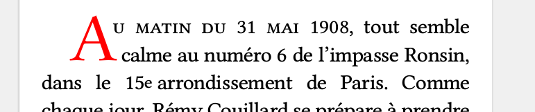

clumsy:
1. drop-caps.
I select between a two lines or a three lines display.
I use just one regex to set up all the drop-caps by inserting simultaneously a double span. I just need the closing tag of an h2 title to start with. Once it's done, I like to differentiate between capitals because some of them have a peculiar shape. "Long" capitals (Q, Ç, J) deserve a special span (from let2 to let4).
2. additional text (small-caps).
As this is a variable text, unhappily I need to proceed one file at a time... It can't be much different elsewhere. I also use a peculiar span with A and L drop-caps, to move this text slightly on the left and avoid a disgraceful white space (from smcpTypeV to smcpTypeA).
Here are the two regex I use in .json format (Calibre editor)
ugly
Now you can judge from the following screenshots, one example with a drop-cap on two lines, a second with a three-lines drop-cap.
ID:	164021   Click image for larger version
