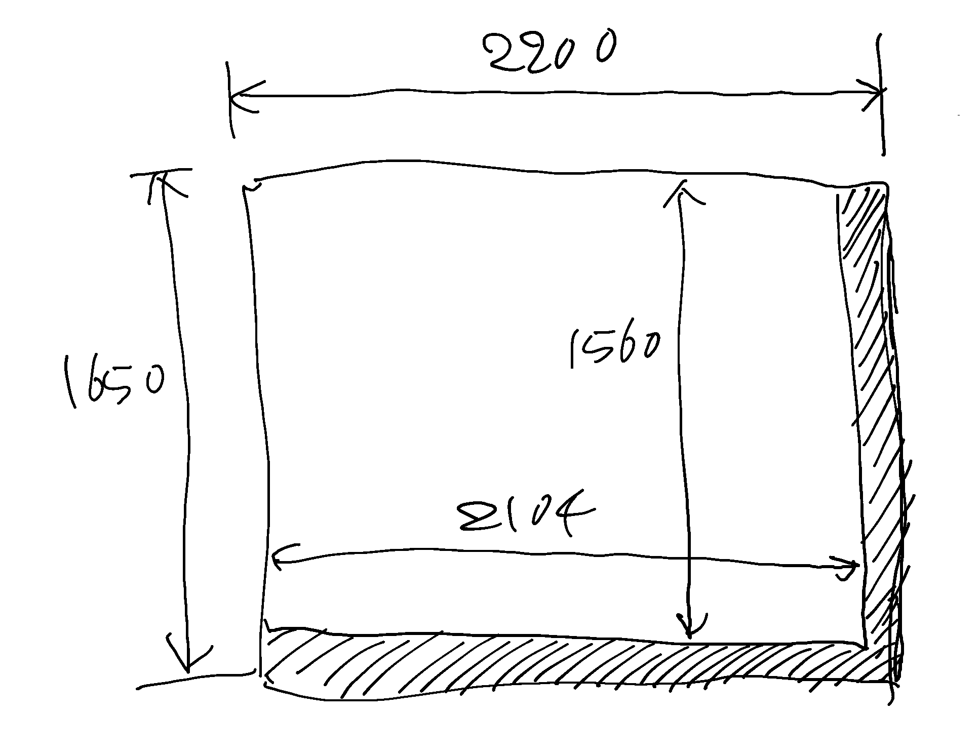

inudaisho
inudaisho began at the beginning.
Posts: 20
Karma: 24
Join Date: Jan 2018
Location: Japan
Device: Boox Max2 / Kobo glo HD
i will explain my idea "1bit-by-1bit mode".
2104x1560 is not full usage of Boox Max2 display but enough big (2104x1560 ) / (2200x1650) = 0.9
so we make a smaller window(2104x1560) and project display image to the smaller window.
it is useful to make the window size unfixed (1024x768, 1920x1080...).
is it possible?
