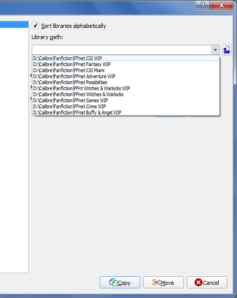

I was thinking something, like this.
Also, if you can choose how many libraries it can remember I would like it to be a bit more than the amount shown in my image. Perhaps 15-20?

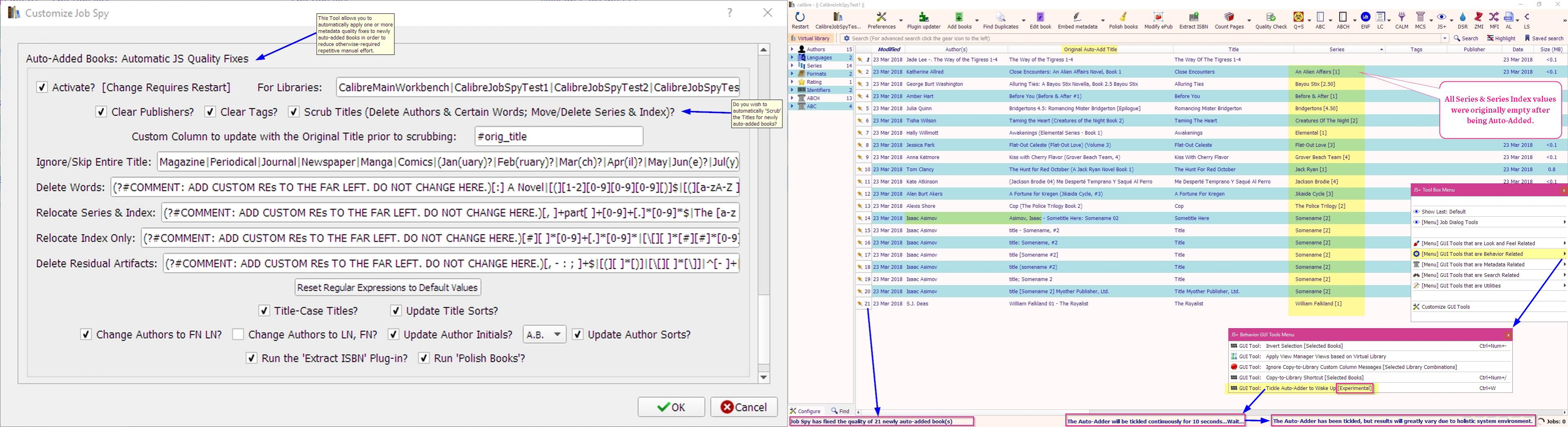

Version 1.0.106 Major Enhancements to 'Auto-Add Books: Automatic JS Quality Fixes'
Version 1.0.106 -2018-03-24 Added to the 'Auto-Add Books: Automatic JS Quality Fixes' GUI Tool: Regular Expression fixes to Scrub Titles of newly Auto-Added books.
Also, a new GUI Tool: Tickle Auto-Adder to Wake Up [Experimental].
See the attached image.
DaltonST

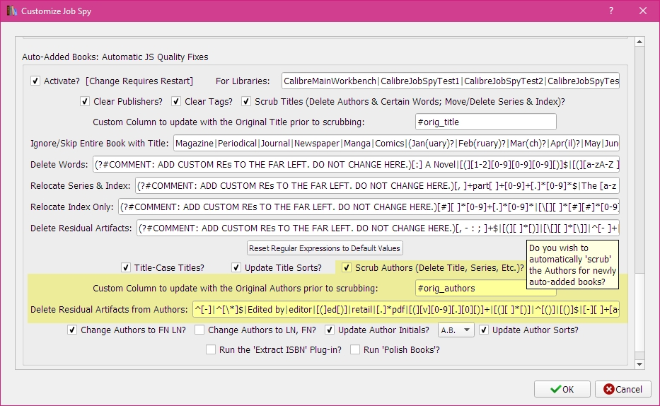

Version 1.0.107 -Added 'Scrub Authors' to Auto-Add Books: Automatic JS Quality Fixes
Version 1.0.107 -2018-03-27 Added to the 'Auto-Add Books: Automatic JS Quality Fixes' GUI Tool: Scrub Authors. Also, Tickle Auto-Adder now tickles for only 2 seconds, not 10 as before.

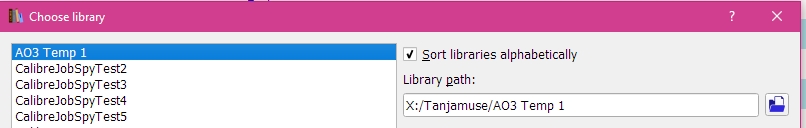

DaltonST
Every time I try to select another library now, it sends me back to my C: drive, instead of where I have all my libraries.
What I had hoped for was a way to select old locations like when I go to choose an existing library in "Choose Your Calibre Library".
Name:	Skærmbillede 2018-03-29 10.16.34.png
