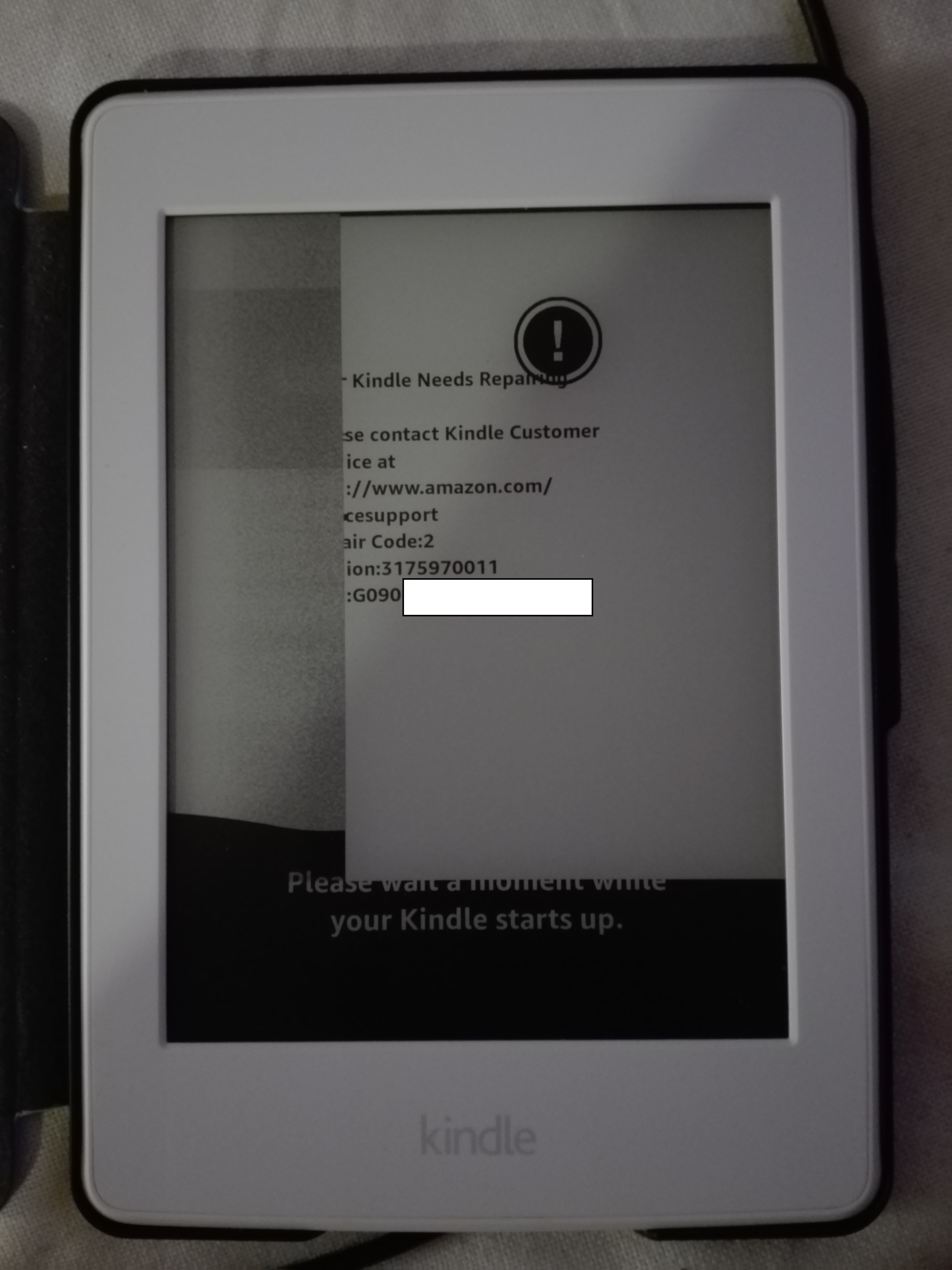

Originally Posted by Kamikakushi View Post
Thank you. At step 4, when I try to update to factory image, the result is a broken screen (picture attached). If I click on the white rectangle, it restarts and gives the same result. Is this some sort of boot loop? Sorry for my noobness, I just couldn't identify the problem.
Data: G090KB, 5.8.10.1, SO removed, parental control and passcode turned off, airplane mode turned on, has been registered with an Amazon account, MD5 hash of the .bin file matched.
https://www.mobileread.com/forums/at...hmentid=161512
If it is running 5.8.10.1 then the special image did not install.
Put the special image at the visible root of the Kindle, then reboot it.
Just a comment, it looks like the factory firmware did install. You can make out version: 3175970011 in the image above the serial number. That matches build number (I assume it's build number) for 5.8.9.0.1. Installation just got borked.
I've been doing more reading and it looks like the same thing that happened here (PW3 5.6.1.1 factory firmware):
https://www.mobileread.com/forums/sh...2&postcount=13
Alas, it doesn't seem like the cause of the bricking was ever positively identified.
Just got my first brick. Will post more details later.

Bricked:
Kindle Paperwhite 3 (used)
  • Is this a new device, never connected to the Internet?
    No not new but I never setup wifi, dunno about previous owner
  • Is it a "refurbished" device?
    No used or third-party (non-Amazon) refurbished
  • Is this the firmware it arrived with or has it been updated to this version?
    No device came with 5.8.11 (3243010037), don't know if stock or already OTA updated
  • Is it registered?
    No
  • Does it have ads (Special Offers)?
    Maybe? I didn't register the device with Amazon so couldn't check.
  • Does it have a pass-code protection or parental controls enabled?
    No
  • What country was it sold in?
    MX? bought from ebay US, contacted Amazon US to see if they can repair but based on serial number, was told to go to amazon.com.mx
  • What country was it delivered to?
    US
  • Was the seller an on-line Amazon site or was it a third-party seller (on-line or brick&mortar).
    ebay: goodystore
Knew this might be more risky since I didn't know the history of the device. Wasn't overly concerned since I already have (1) PW3 5.9.4, (1) JB PW3 5.8.9.0.1 and (1) JB PW3-32 5.8.11. More details to follow.

jprince's post perfectly describes what I saw so copying his post and just editing the relevant parts.
First eight characters of serial number: G090 G105
Firmware version before you started this procedure: 5.8.11
Feature related:
Was this Kindle registered with Amazon? no
Was this an ad supported (Special Offers) Kindle? maybe? purchased used
Was a passcode set? no
Special sub-steps:
Did you clear the passcode before the downgrade? no passcode was not set
Did you do the 'Reset (to factory results)' sub-step? no, it was already factory reset when I got it. Never connected to wifi, no books ever loaded (by me). However, I did run the following and didn't factory reset afterwards (yeah, stupid of me).
;dm
;st {date time}
;dm
Internal data related:
Using the Kindle's Cloud Account or local or both? neither
Where you using collections? no
Where you using bookmarks? no
Where you using annotations? no
Native language in use: US English
Kindle Hung:
What is the filename of factory initial update that was used? update_pw3_factory_5.8.9.0.1.bin same file used for two successful jailbreaks
Which mirror did you get it from? adrive
Confirmed
MD5: 5d38744bd01f4cbf457dae4499c3c32a
SHA1: 3a5d9418a0cdb307f27494ddddd6c187160e8641
Approximately how long did the downgrade process run? 10-20 minutes?
What was showing on the screen when it 'hung'? It cycled to boot, however, the "active" graphics don't fill the whole screen, rather the upper right.
When the USB cable was connected, Kindle to PC, could you see the storage on the Kindle? yes, originally, however, after trying DO_FACTORY_RESTORE, it no longer mounts user store. However, the first time after that, it proceeded to ask what language I wanted to use. The graphics were/are still small, but the onscreen hit targets matched as if it were full size. Regardless, hitting Next lead back into boot cycling
What sort of response did your PC make when you plugged in the Kindle? originally, mounted via USB for a short time
Did using a USB-2 vs a USB-3 port on the PC make a difference? n/a
Was this same cable and same port working normally before the downgrade? yes
Normally, a Kindle is re-booted without any USB cable connected.
Leave the USB cable connected, Kindle-to-PC, re-boot Kindle (hold power button 40 seconds or more, ignore any pop-up panels seen).
What was the result? Same, now. Actually, 40 seconds doesn't seem to change anything. It continues to boot cycle as if you were not holding the power button.
What OS and OS version in use on your PC: Windows 7 32-bit
USB-2 or USB-3 ports, or both? USB-2
Recovery:
If your PC could 'see' the Kindle storage (even briefly) try putting a file named:
DO_FACTORY_RESTORE
(all caps, no extension, no contents)
into the top level of visible USB storage.
Then use the power button to re-boot the Kindle
describe the result here: Described above
Does the 'hung' Kindle boot far enough to show the main screen, can you access the search bar? no
Yes, I know I shouldn't have done the DO_FACTORY_RESTORE per hius' warning. I got impatient. Might eventually try a serial debrick but in no hurry to do so.
