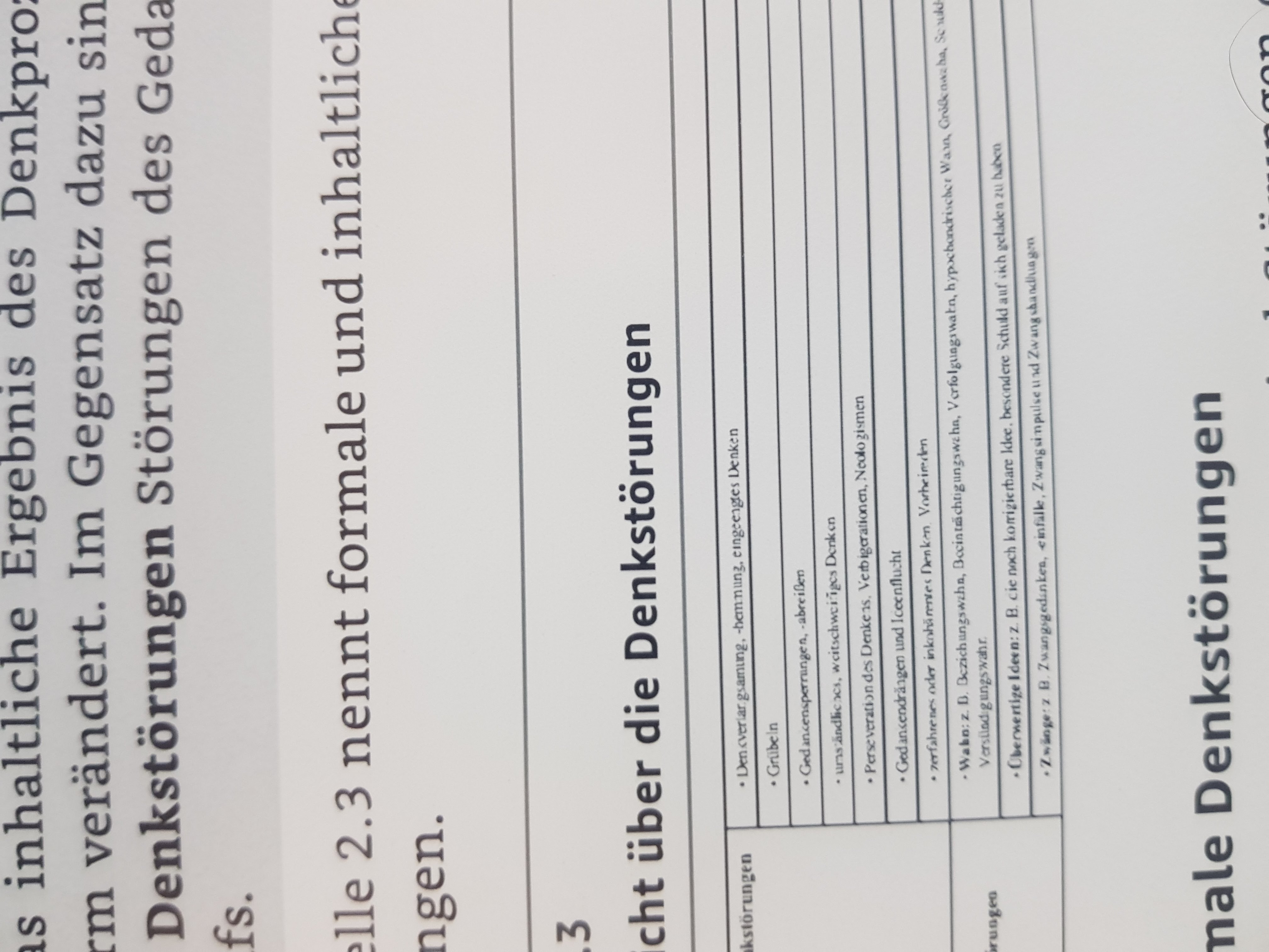

thank you for notifying. So after manually updating through USB method. I deleted the book and re-downloaded it again. It was still in AZW3 format. I hope after reaching higher adaptation of this version the ebook would be sent in KFX format to the Kindle.
The converted KFX using calibre displays some tables the same/worse as/than AZW3, in both cases partly unreadable without zooming. see the attachment. lineralizing them messes the format of the rows and columns.
It is a step forward and the KFX feels snappier.
OT: the automatic light levels seem to react better too.
