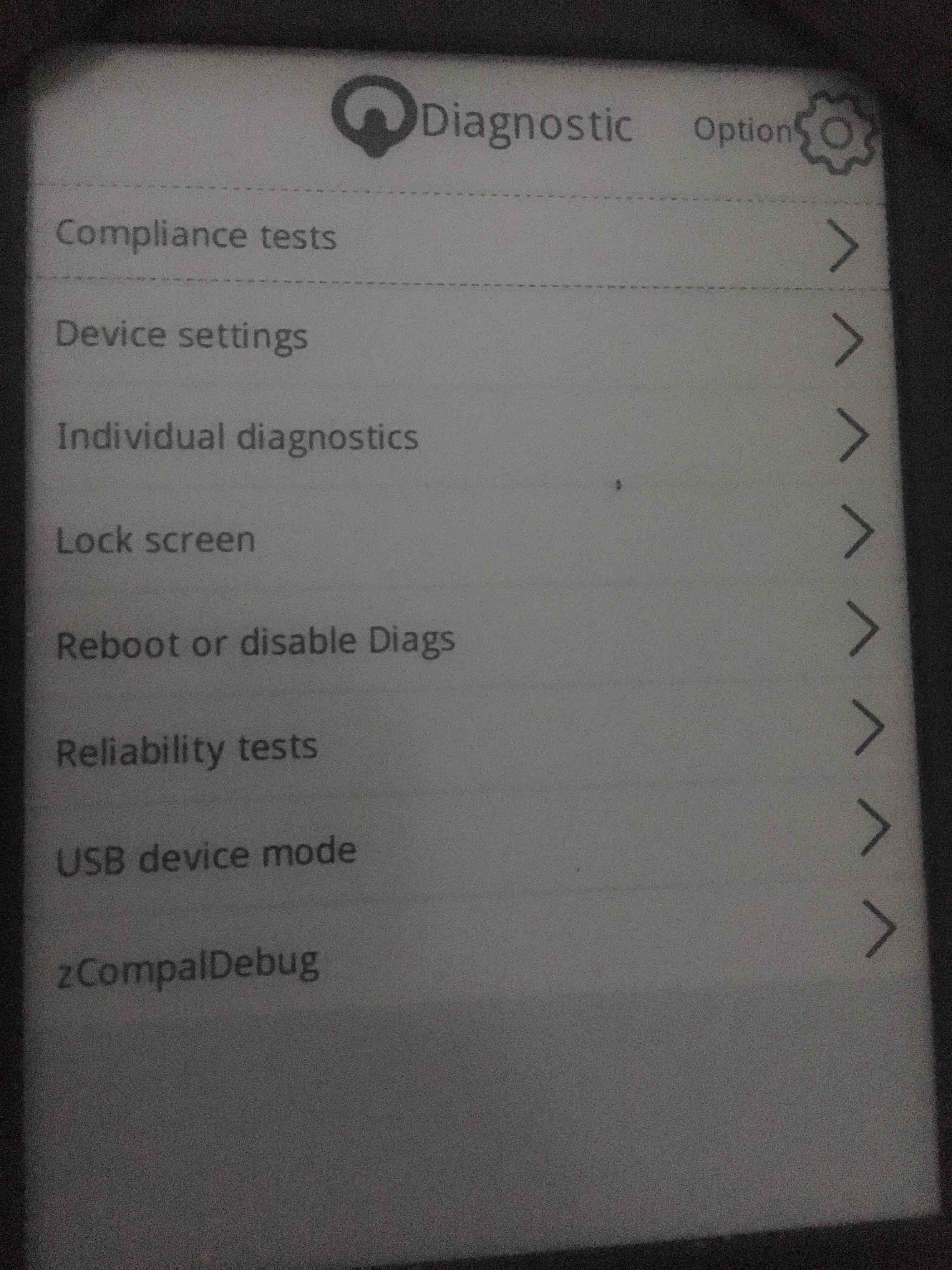

the ssh server does not start when the Kindle is started, I attach the diagnostic screen

"Reboot or Disable Diags"
You might have to search the forum or use the master index to learn how to use it.

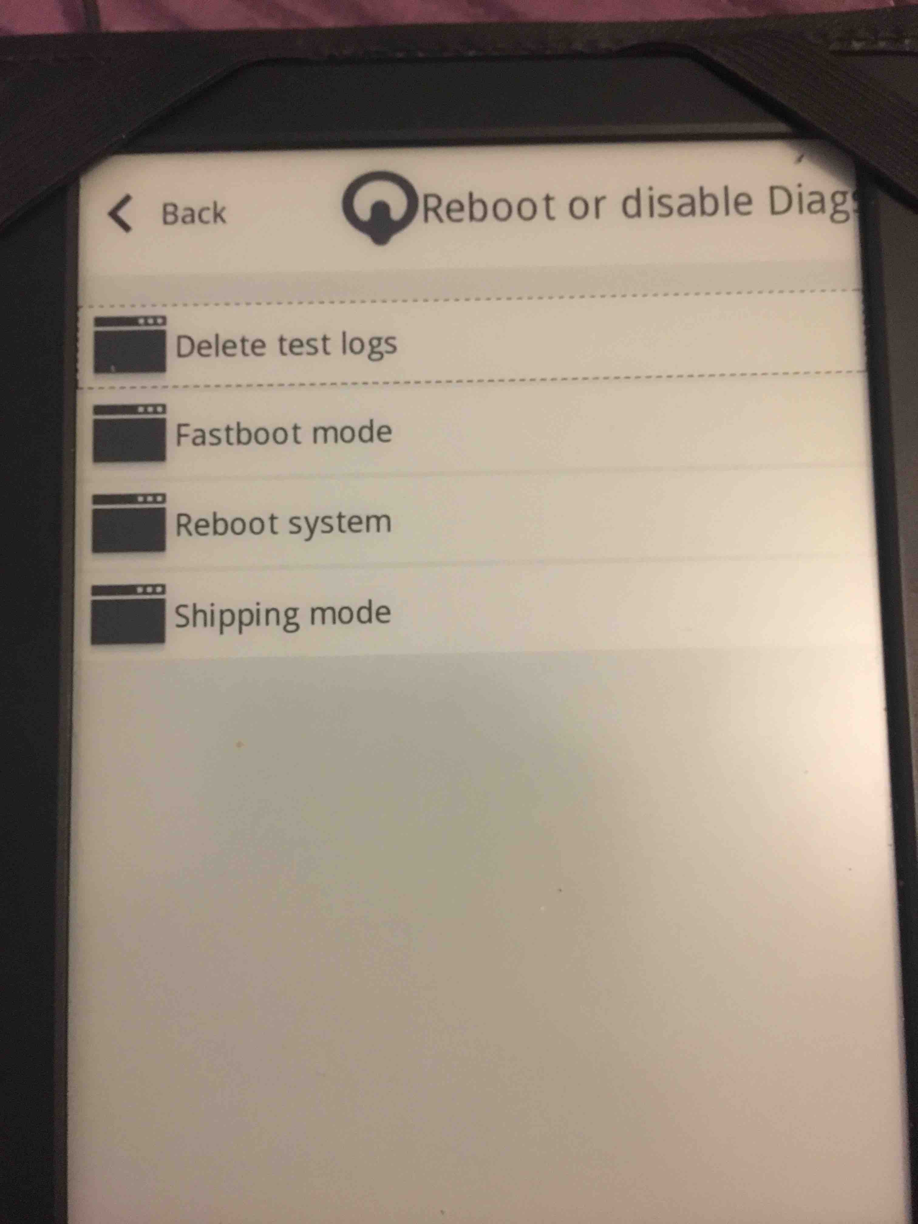

Hello, inside "Reboot or Disable Diags" only options are:
  • Delete test logs
  • Fastboot mode
  • Rebbot system
  • Shipping mode
the option to disable diagnostics is missing.
I read some threads of the forum about DIAGS and Debricking, but I have not been able to solve it.
Any ideas?

Have you tried the Rebbot choice? I think there is another menu level there.
OR
Put it in fastboot mode and then use fastboot from a PC to reset the bootmode value you changed.

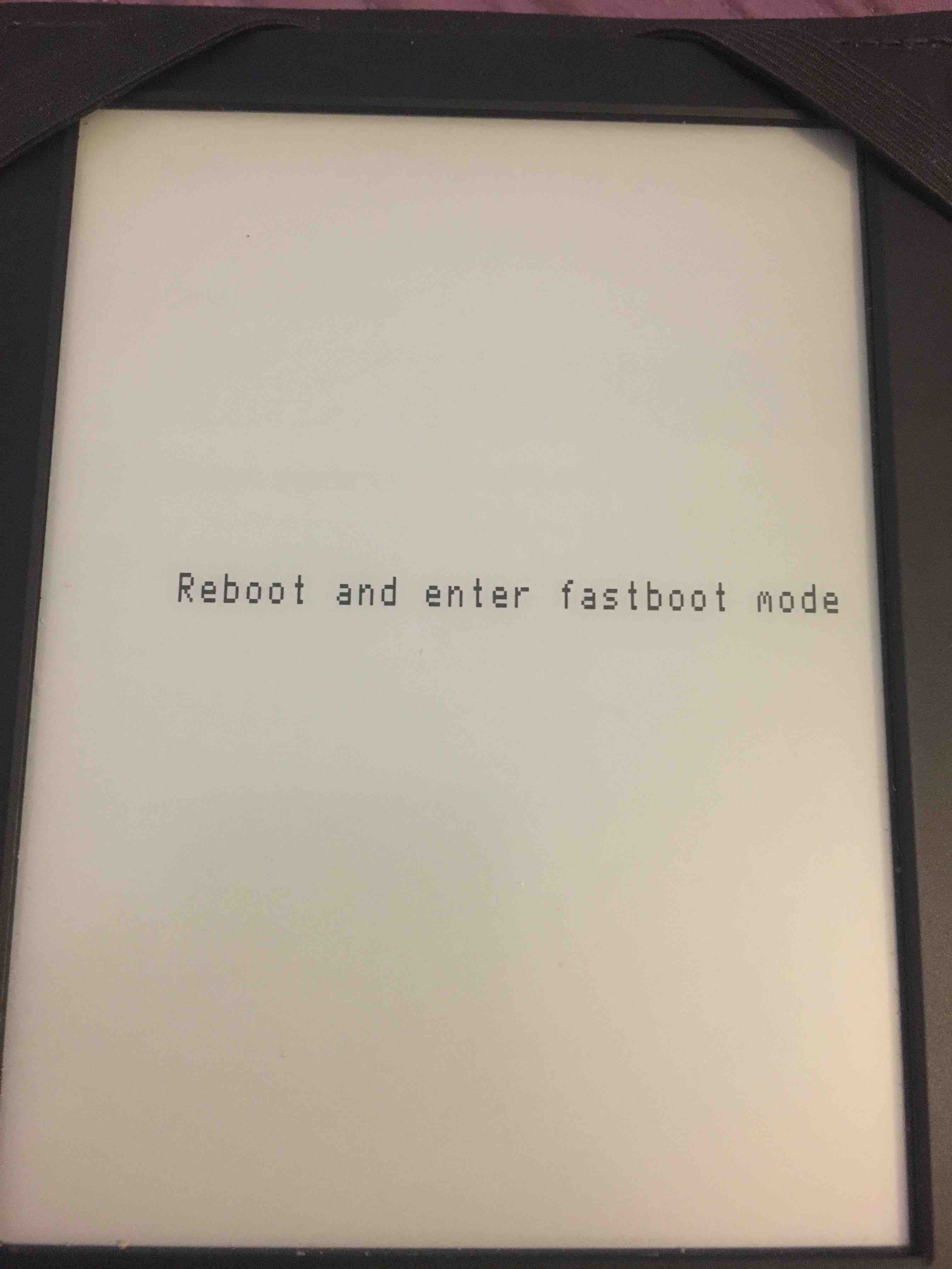

Yes, I tried the Reboot option, the kindle restarts in diagnostic mode again.
The Fastboot mode option leaves the kindle stuck, showing the message "Reboot and enter fastboot mode", but does not restart.
I think a paperweight was born.
It is not stuck.
Kindle in fastboot mode does not have any visible on-screen feedback.
Use the Kindle-specific version of fastboot (available on this forum).
Also, the directions of the Kindle PC fastboot has built-in help.
Plus, there are numerous examples of its use posted here.
It is not a Paperweight -
It is just in "educate the fool trying to change things" mode.
