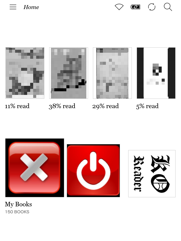

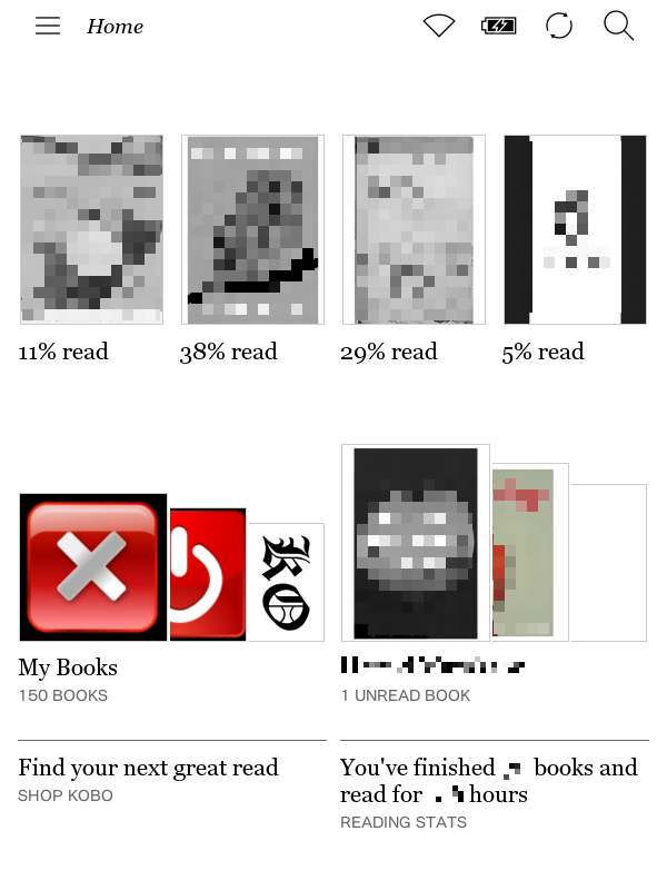

Thank you, works well on my Kobo Mini. I attached two pictures, one with "New home screen increasing cover size" activated and one with the quoted patch.
Is this replacement on the top some kind of qt .ui file? Simple disassembly doesn't seem to do the trick and the bytes before the patch address is layout data in ascii. Any hints for understanding the patch? Would it be possible to add a second book row?
I'm glad it works.
The code involved is in zlib 74.
#row1col2,#row2col2,#row3 {qproperty-visible:false;}
Perhaps, but I don't think so.
Good luck.
