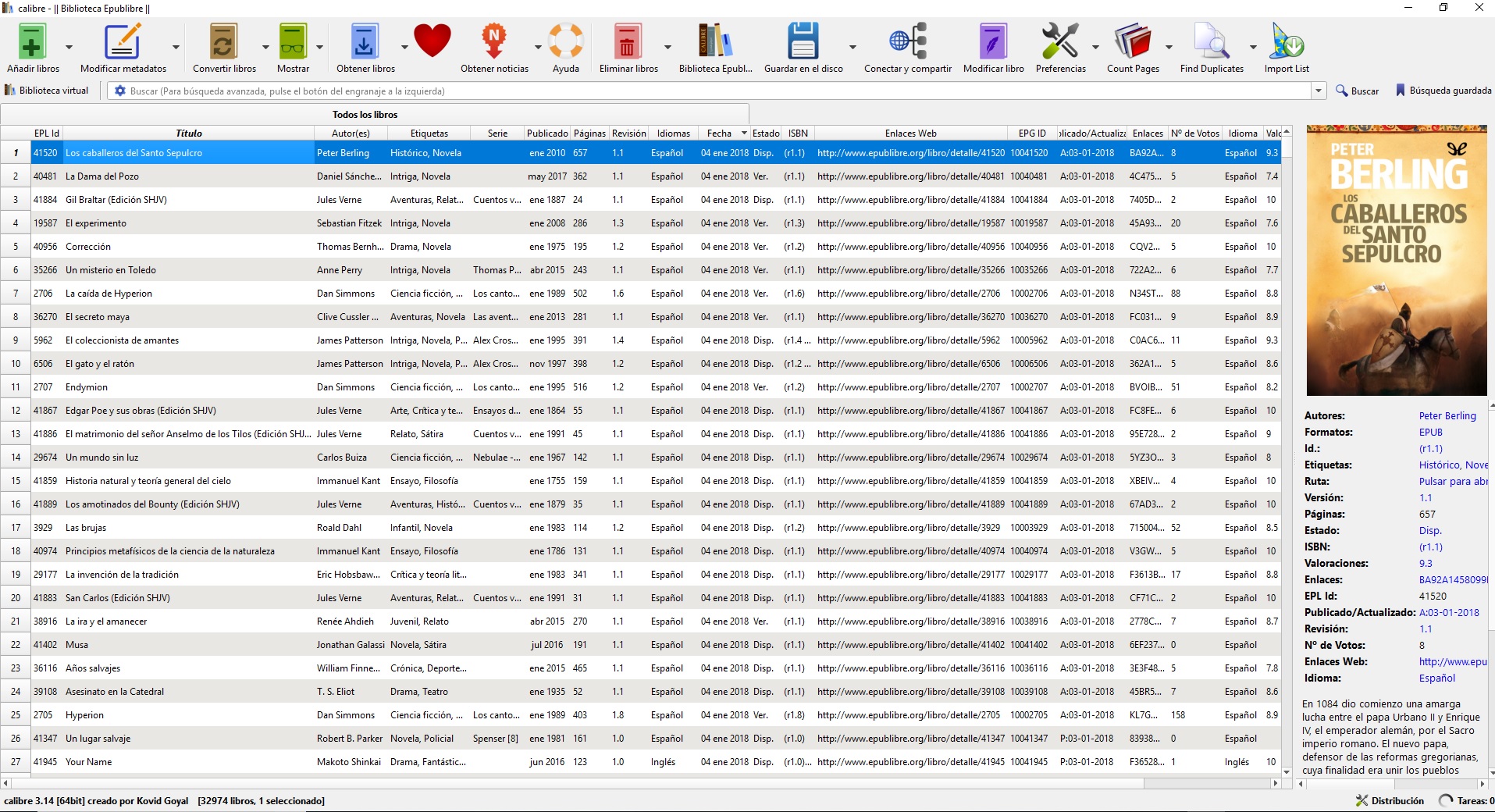

Old 01-04-2018, 10:13 AM   #296
marm2017
marm2017 began at the beginning.
Posts: 6
Join Date: Sep 2017
Device: Calibre
Are you selecting the language as a column to update but the input has no value? And where are you importing from? A web page or a CSV file? It would be goo to have an example to look at to work out what is happening. If you can post or PM a sample, then I'll look at that.
And what version of the plugin are you using? You linked to a post with a beta attached. Are you using it or the released version?

marm2017 is offline   Reply With Quote
Old 01-04-2018, 10:17 AM   #297
Terisa de morgan
Terisa de morgan's Avatar
Posts: 6,686
Karma: 12595249
Location: Madrid, Spain
If I'm reading the images right, you have two columns: "languages" and "language", and the same field goes to both columns. One is updated (language) but not the other (languages). Am I right?
Terisa de morgan is online now   Reply With Quote
Old 01-04-2018, 02:03 PM   #298
marm2017
Posts: 6
Join Date: Sep 2017
Device: Calibre
Sí. La columna Idiomas es de Calibre y en ella se añade automáticamente el idioma correspondiente al añadir un libro. El problema es que al usar el plugin Import list, la columna Idiomas se borra. Por eso creé la columna Idioma para incluir entre otros datos el idioma a través de un archivo CSV. He probado de todo. Incluso a no incluir Idioma para actualizar con el Import list. Pero aunque solo use las columnas título y autor, los datos de la columna Idiomas se eliminan. Es la única columna afectada, el resto de columnas no sufre alteración alguna.
