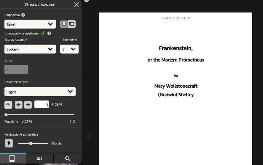

Hello,
I intall kindle previewer 3.16, then I install the kfx plugin from Calibre.
I restart Calibre.
But when I convert ebook from epub to kfx I have un error:
calibre, version 3.12.0
ERRORE: KFX conversion failed: Cannot convert Frankenstein
Conversion error: Kindle Previewer error: Error(YJEpubAdapter):E00601: Internal error occured. java.lang.UnsatisfiedLinkError: C:\Users\Sara\AppData\Local\Amazon\Kindle Previewer 3\lib\fc\lib\shared.dll: Can't find dependent libraries
something is missing?
Sara

Thanks for the detailed error report. I haven't seen that error before, but it appears that a component of the Kindle Previewer is missing on your system.
You can try to open that Frankenstein book using the Kindle Previewer's user interface (outside of calibre) and see if it shows "Enhanced Typesetting: Supported". If not then something is wrong with the Previewer installation.
The most likely cause is anti-virus software incorrectly detecting one or more files as containing malware and quarantining them. Check your anti-virus software to see if this has occurred.
Otherwise, you could try removing and re-installing the Previewer.
I open Frankenstein book using the Kindle Previewer's user interface.
Waiting for conversion and then it open the book.
I'm not sure what means "Enhanced Typesetting" because I have italian version of kindle previewer. But I post the screenshot. Perhaps means "Composizione migliorata"?
Yes. That appears to be working properly.
I do not know what could be causing it to fail when invoked by the KFX Output plugin. I will think about this some more and let you know if I have any ideas.
