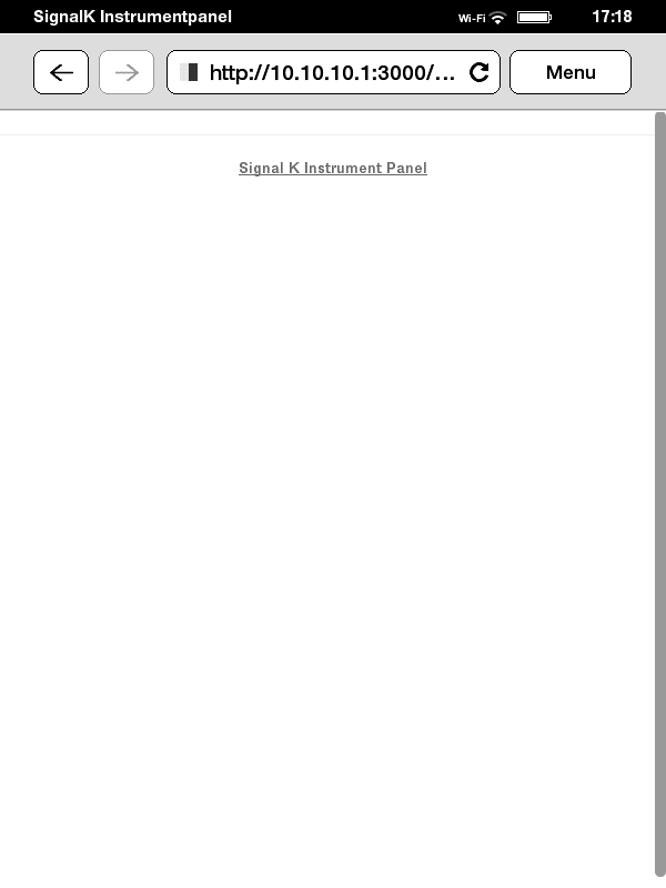

with the Experimental Browser I can reach 10.10.10.1:3000/@signalk/instrumentpanel
but I have this ......
.......instead of this:
this is the link of gitHub signalk page https://github.com/signalk/instrumentpanel
