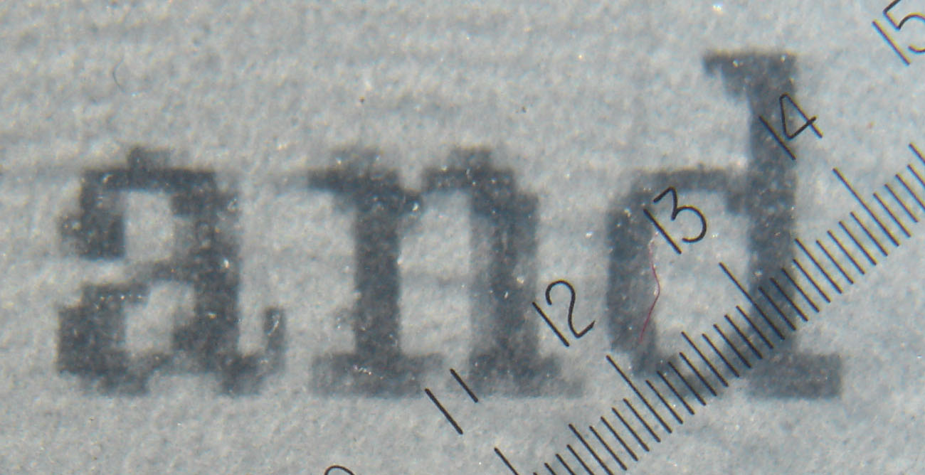

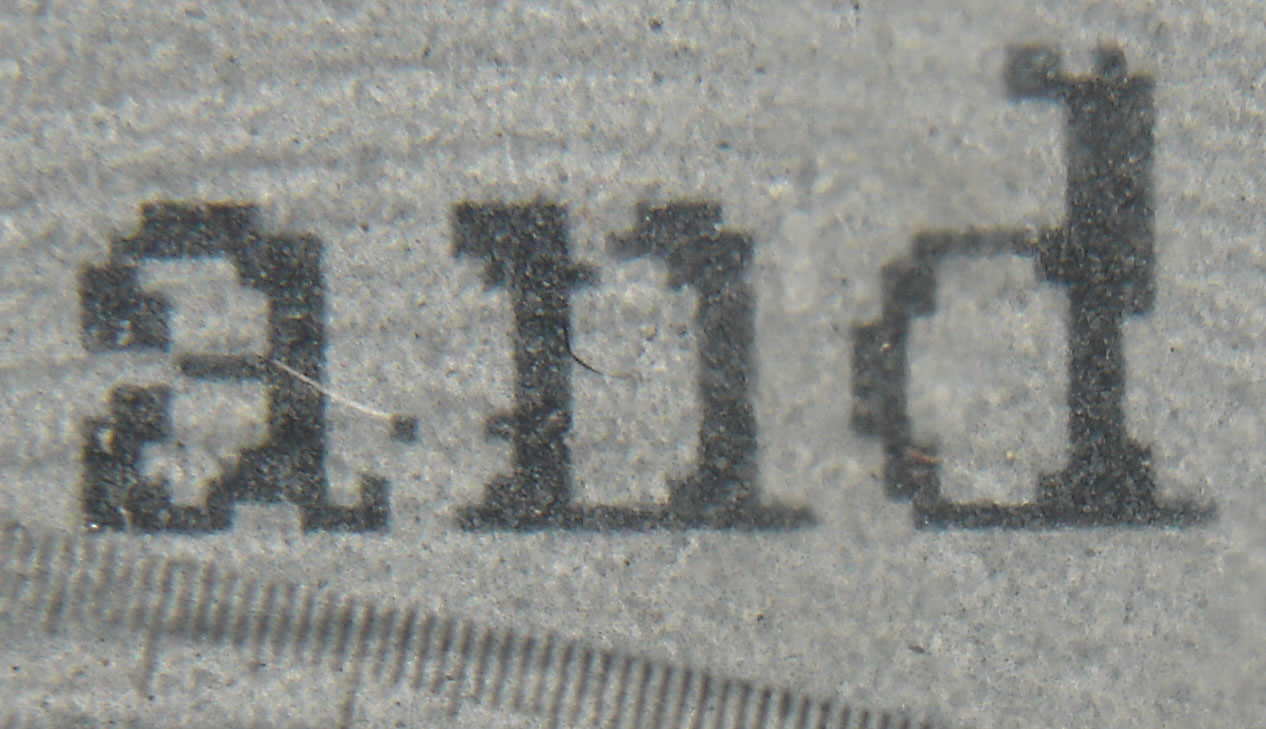

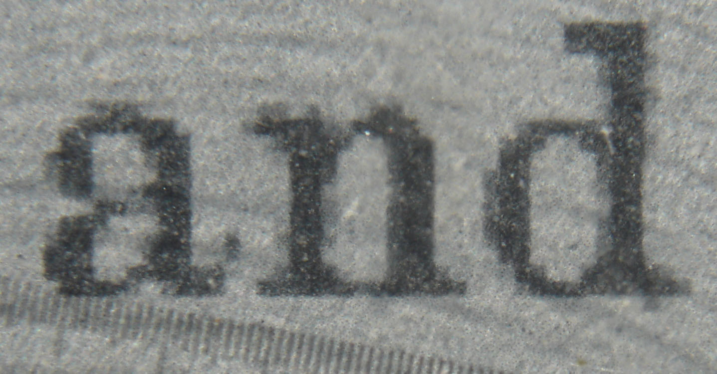

I've use a hand lens to have a closer look at scanned text and it seems to me
that the algorithm used by the Iliad results in anti-aliasing for scanned text.
Scanned text at 600 bpi is often very well done by the Iliad.
I took a bit of text, an "and" from a page 3.5 x 5.0 inches scanned at 600 bpi
and photographed it as displayed on the Iliad and also on the Sony reader.
Both displays show the characters a bit larger than the original - Sony's display
in landscape is similar to the Iliad in portrait - I also converted the original
tif - a bitmap - of the "and" to a pdf for comparison and photographed the same
"and" slightly zoomed on the Iliad.
A millimeter scale was overlayed on the displays - the small divisions are
0.1 mm. The Sony display and the Iliad display are quite different. The Sony
display algorithm seems to have downsized to a bitmap - the pixels are either
on or off. The Iliad display, appears to me at least, to have downsized with
some anti-aliasing. The original "and" on the paper was about 4.4 mm wide, on
the Iliad picture, Iliad-small, and the Sony reader picture it is about 5 mm wide, and
on the zoomed Iliad picture - Iliad-large - it is about 6 mm wide.
Any comments ? Can anyone comment on the Iliad display algorithm ?
