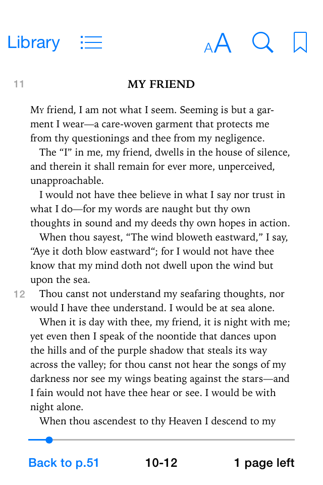

Doitsu had noted this at the time:
Originally Posted by Doitsu
The downside of page number target references is that there aren't that many ePub apps that actually support real page numbers.
IMHO, this was best solved in iBooks and, AFAIK, the only free app that shows real page numbers is Azardi, however Azardi doesn't actually use the page list; it generates the page numbers from the page number target anchors.
This is how the page numbers displayed in iBooks on an iPhone 4:

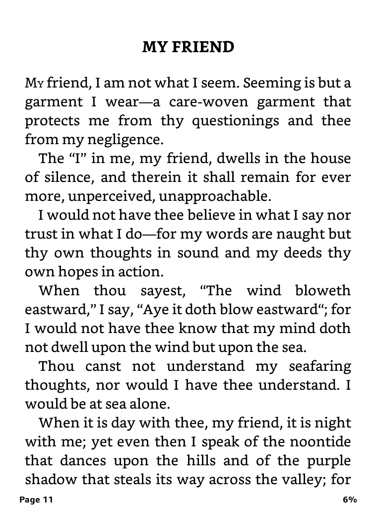

Originally Posted by Notjohn View Post
Will that epub3 pagination carry over to the "mobi" that KDP makes of it? If so, maybe it's time for me to leave epub2 behind, tee hee.
If you convert the EPUB->MOBI, this is what a physical Kindle looks like (note the "Page 11" in the bottom left corner):
Note: At least back in 2016, the "real page numbers" DO NOT SHOW UP in Kindle Previewer. Only showed on physical devices.

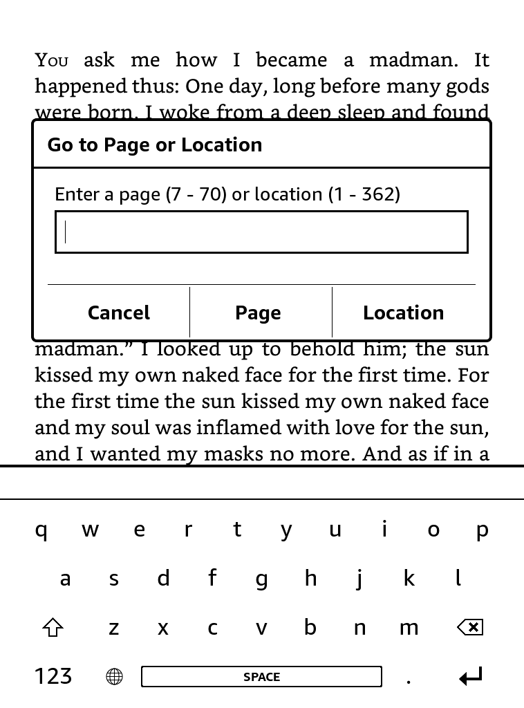

Side Note: Doitsu mentioned you can Go To "real page numbers" on Kindle:
On Kindle touchscreen devices you can toggle the display between: location, page number, time left in chapter, time left in book and no indicator at all. (In my screenshot the location number is 22.)
Note that eInk Kindles will only display the first page number if a page contains two page breaks.
BTW, if a book contains "real page numbers," you can also enter a page number in the Go To dialog box. (In books without "real page numbers" no fake page numbers will displayed and the Go To Page option is disabled.)
Here is the picture he gave me of that:
