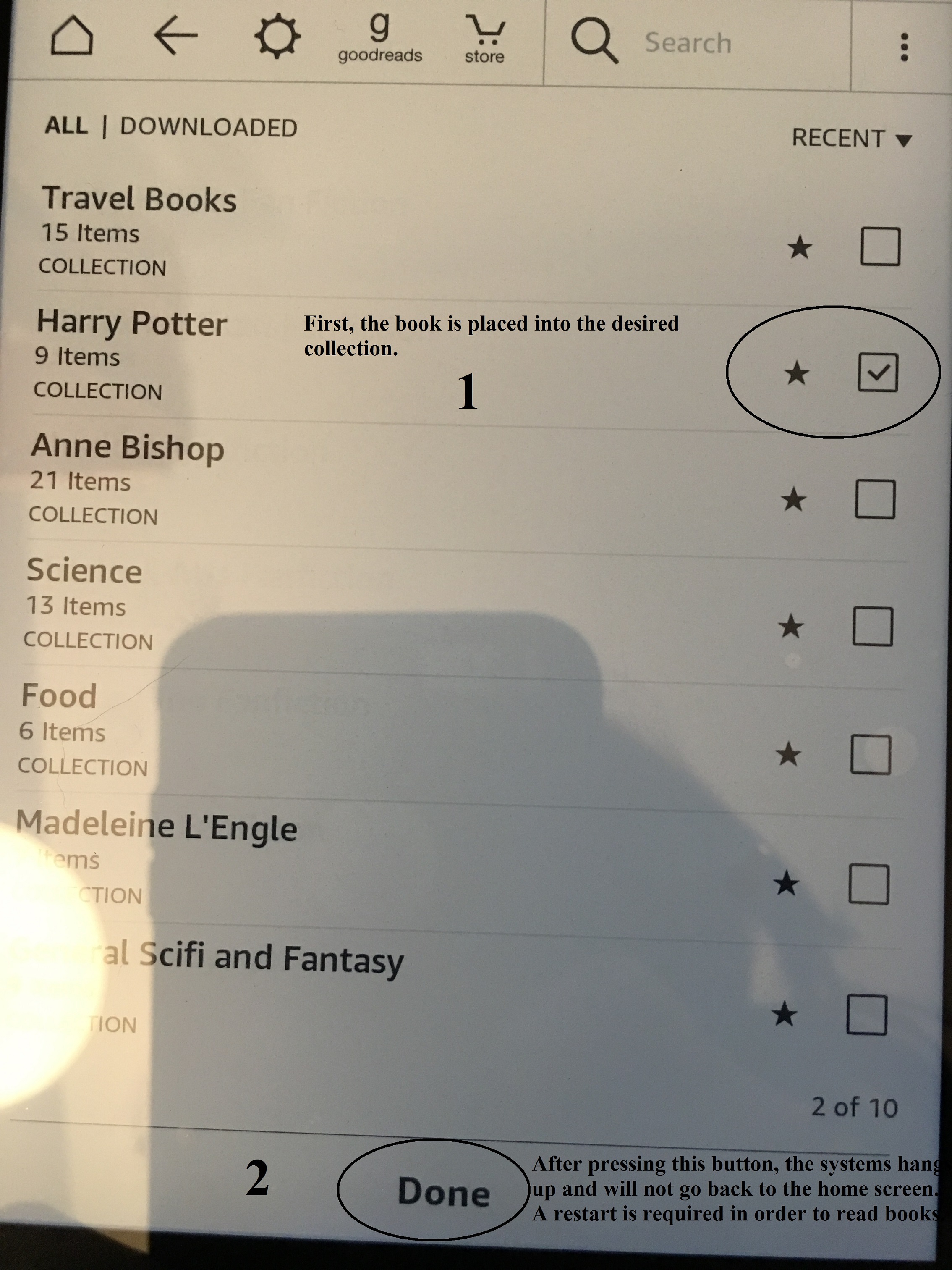

Hi,
I'm looking for some technical help with my Kindle Voyage (firmare 5.8.10); and I did have this jailbroken before the update.
I just recently added a bunch of books and I usually use the LibrarianSync (with KUAL) on the Kindle with Calibre to put books into collections. Well, sometimes it works and sometimes I have to add the books manually to collections.
The problem I am having is when I try to add books to collections manually. The Voyage will not go back to the home screen after checking the box to add the book to the collection. The Kindle appears stuck after pressing the 'done' button. I can get to the settings screen to restart it.
The only way to 'un-stick' the Kindle is to restart the device. I can read books just fine, but the Kindle will 'hang' itself when I try to add books to collections. I even updated the firmware today (Sept. 12); and that didn't fix the problem.
Any suggestions? Or do I need to do a factory reset? I really don't want to do this because I don't want to start over from scratch. I had a really hard time jailbreaking it in the first place.

Thanks for the tip about the 'reset' button. I have not pressed that yet.
I am including a screenshot of where I am having the problem. With the Kual/Librarian Sync: I was using the interface with Calibre. I use Calibre to transfer all my books, then use the Kindle Collections plugin on Calibre to sync the collections. I then use the "import collections from Calibre" on Librarian Sync on the Kindle to complete the process. Most of the time, this adds all my books to their respective collections.
I started having problems a few days ago (before I updated the firmware) with adding books manually on the Kindle to their respective collections. These were the books that the Librarian Sync did not add. The Kindle hangs up on the screen where you can add an individual book to each collection. The "done" button is at the bottom of the screen; and when I click it; the Kindle does not go back to the home screen.
The screenshot is attached. I have also attached the zip file for the files after I ran ;dm.

I'm not sure I follow. I don't understand any of the dump files.
I've tried doing the ;dm. And I have then tried adding books to the collections on the kindle manually. And then the Kindle hangs up on the collection screen (just like in the attached photo). I then have to reset the kindle in order to get it back to the home screen. After I reset the Kindle, I can read books. But if I try to add any books to any collection, I then have to reset the Kindle after every book. This is the problem. I have never had to do so many resets with the Kindle before.
In other words, I can read books on the Kindle, but not add to collections anymore without a huge hassle.
Wrong order, do this:
1) And I have then tried adding books to the collections on the kindle manually.
2) then the Kindle hangs up on the collection screen (just like in the attached photo).
3) After I reset the Kindle
4) NOW use the ;dm command, before doing anything else.
5) stick all four log files (the most recent if you have more than four) in a *.zip file, attach to your next post.
