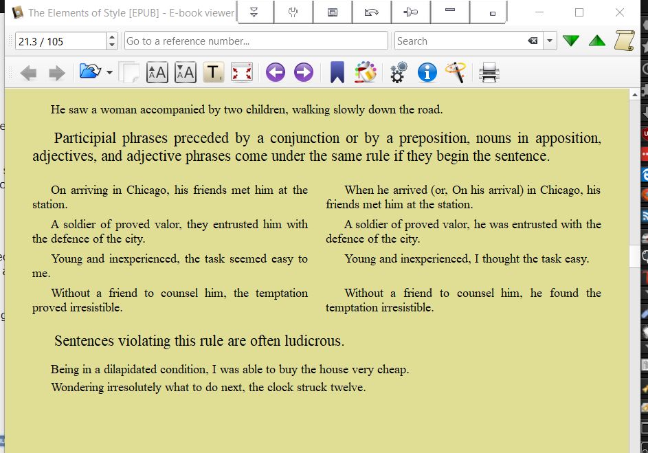

@Heathside Boy - I have it in ePUB from Gutenberg, sample :
IMO, the left/right examples would be better off without the hanging indents.
