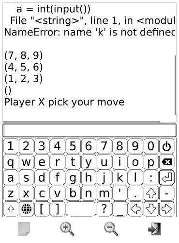

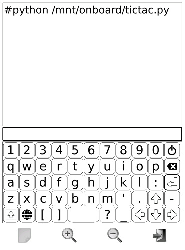

Hi, thanks for making a terminal. I have found one problem with it, I installed python on my kobo and when I try to play a simple command line based tic tac toe game with python like this, python /mnt/onboard/tictactoe.py it won't display the application. And then when I type a letter it quits the application and then shows the application in the history of commands you entered. But since it left the application I can't play it anymore. So the only way to get the konsole to show the application is to type in a letter, and the application doesn't recognize it as a valid symbol and quits. Then the application shows up in the history of the commands you entered. Is there a way to get it to display the application without quiting the application first? I hope you understand what I am trying to say. Attached are two screenshots.

This is because python is running without tty and thus buffers it's stdout. Probably I can't develop real terminal emulator for kobo because it has limited kernel (without pseudo terminal support)
For now the only solution I have is to put these lines at the beginning of your script:
class Unbuffered(object):
def __init__(self, stream):
self.stream = stream
def write(self, data):
self.stream.write(data)
self.stream.flush()
def writelines(self, datas):
self.stream.writelines(datas)
self.stream.flush()
def __getattr__(self, attr):
return getattr(self.stream, attr)
import sys
sys.stdout = Unbuffered(sys.stdout)

Thanks for your help! I added that code but now it says unbuffered object has no attribute write. So I guess I will just have to give up for now on getting python programs to run on a kobo.
Edit: Actually I made a mistake in the spacing on the code. It doesn't give that error anymore when I test it on the computer. Now to test it on the kobo.

Thanks alot everyone for your help! It works perfectly now on my kobo.
