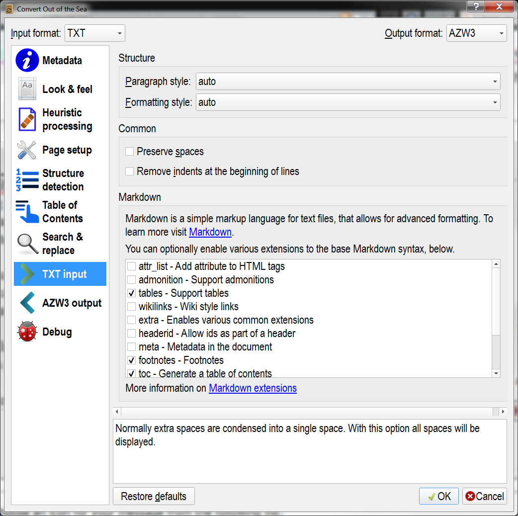

I have just finished entering my ebook collection into Calibre 3.8. Can anyone please show me how to stop Calibre from breaking the text (almost) at the end of every sentence (actually every second line)? Can't I have it convert the text as it appears in the original txt or pdf (complete paragraphs)?

To convert txt you simply have to play with the txt input settings (see attached) during conversion. Specifically the structure section. These often need to be manually entered because auto doesn't always work.
