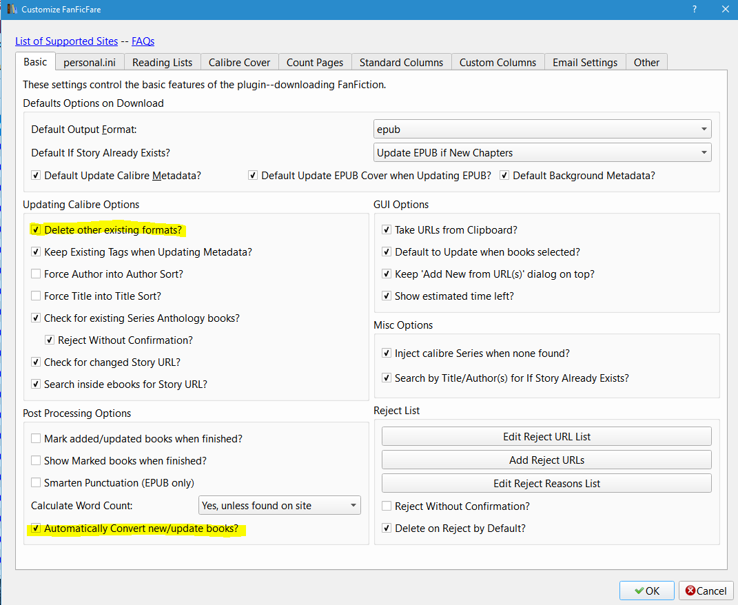

So, uh, possibly a noobish question, but I can't for the life of me figure it out.
I've got some 250 fics/quests downloaded, and of those about fifty update regularly. The update function works without much issue, other than the SB/SV issues everyone's got, and those aren't a problem since I moved over to the test version. On my computer, everything updates normally, and I can read the latest update on the ebook version I have downloaded.
The problem is with my device. I can't figure out why, but once I sent the ebooks over to my Kindle Fire HD8, that's the version that's permanently on the device. I can delete my library from my KFHD, but even if I do that, if I send the ebooks from my computer to it, it's still stuck on the old version.
Example: Intrepid, in my Calibre library, has 168 chapters. Intrepid, the same story, on my device, has 165. I can delete Intrepid from my KFHD and send the Calibre version over... but it still only has 165 chapters for some reason. I've gotten around this once, by changing the format of the ebook I'm sending over to mobi, but I can only do that one more time by switching to pdf; the azw3 format I formerly used only sends over 163 chapter of that story.
Can someone explain just why this is happening? Or is this a calibre problem, rather than a FFF problem? I'm not too concerned by the problem itself, I'm more curious as to what would cause it.

@ziggy9942:
It sounds like you are using FFF to update epub (which is what I recommend), but not updating the azw3 format afterward.
You can test that by manually converting from epub to azw3 and sending that format to your device again. You should then have all chapters.
I use a Kindle Voyage myself, and FFF has some settings to help. See highlighted:
One deletes the other (now outdated) formats on download, the other kicks off a convert automatically for each updated book. Note that you need to have your default convert-to-format set appropriately in calibre.

That worked perfectly, thanks!
