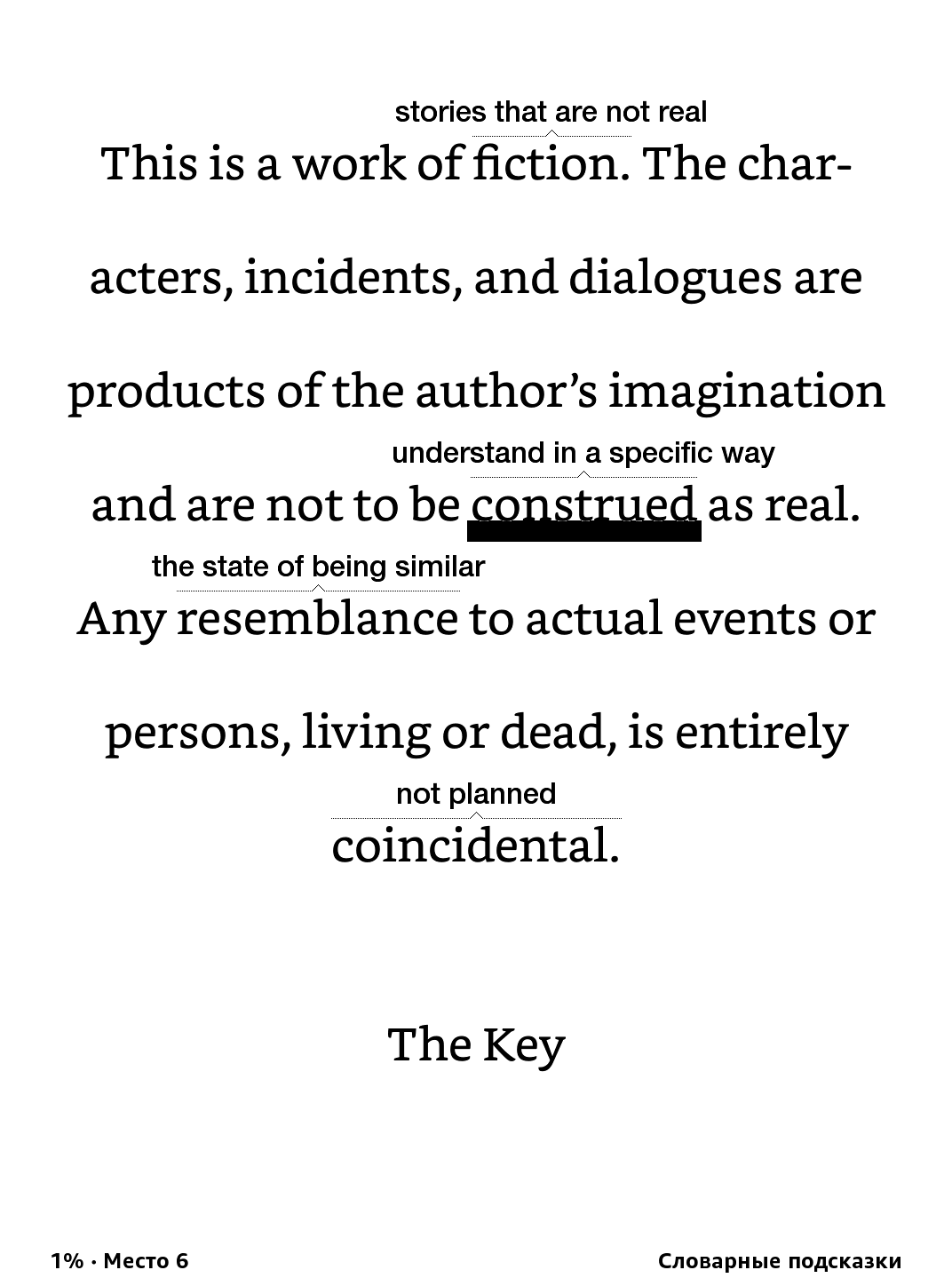

Hi everyone, this is my first post here
I have new Kindle Oasis with Jailbroken firmware version 5.8.7.0.1. I noticed that Word Wise does not show hints for hyphenated words on Kindle. I attached a screenshot of the same page on Kindle for Android versus Kindle Oasis. Actually I noticed this issue starting from the initial shipped firmware 5.8.2.1.
Any idea if this has been fixed in more recent version of the firmware? I would appreciate if someone can try and let me know.
Thank you.

I confirm the existence of a problem. KPW3 Firmware 5.8.7. But such situations are very rare. Hints for some words with hyphens are present.

I tried it on a PW2 running 5.8.10 and saw the same thing. When I changed the font size in a book so that a word became hyphenated it lost the Word Wise annotation.

OK. I upgraded firmware to 5.8.10. Problem still exists. When I changed the font size in a book so that a word became hyphenated it lost the Word Wise annotation. But when I changed the font size in a book some words lost the Word Wise annotation too even if there is no hyphen...
