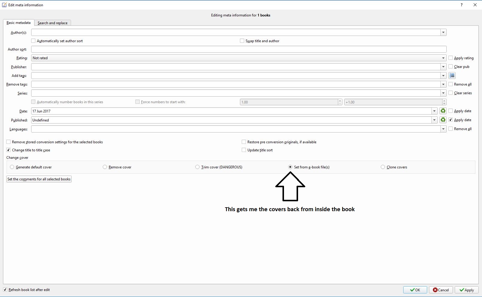

Adding the cover back after using the 'filename' option (i.e. no covers) is also not really a problem using 'Change Cover - Set from ebook files', although this is an additional step

I've included some attachments for those who may not be familiar with the 'importing from filename' and 'adding covers from ebook' options

Since the files have the same pattern, why not use Bulk Mode Metadata edit
to 'move' the pieces to their proper location
Oop! forgot Search and replace (tab)
Thanks Ducks - I'll be having a play a bit later...
