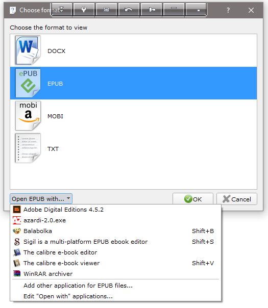

I don't know whether this has anything to do with your problem, but I recall that a couple years ago when I switched from Calibre 1.x to 2.x, it crashed when switching libraries. In my case, it had something to do with the Open With plugin. Installing a previous version of the plugin fixed the problem.
If you have the Open With plugin installed, you might try temporarily disabling it to see if that's causing the issue. If not, you could try disabling other plugins as well.
You could run calibre with the --ignore-plugins option, see ==>> User Manual CLI - calibre

Originally Posted by loviedovie View Post
Ok I uninstalled it, and calibre does not crash so it seems like Open with is the culprit but it is a bit sad because that is the plugin I use the most ;(
I also use Open with a lot.
Prior to Kovid implementing the built-in Open with feature I used the Open With PI. When I found I didn't have anything in the PI configuration that I couldn't do with the built-in version, I switched to it and removed the PI. This is what I have for ePubs.
