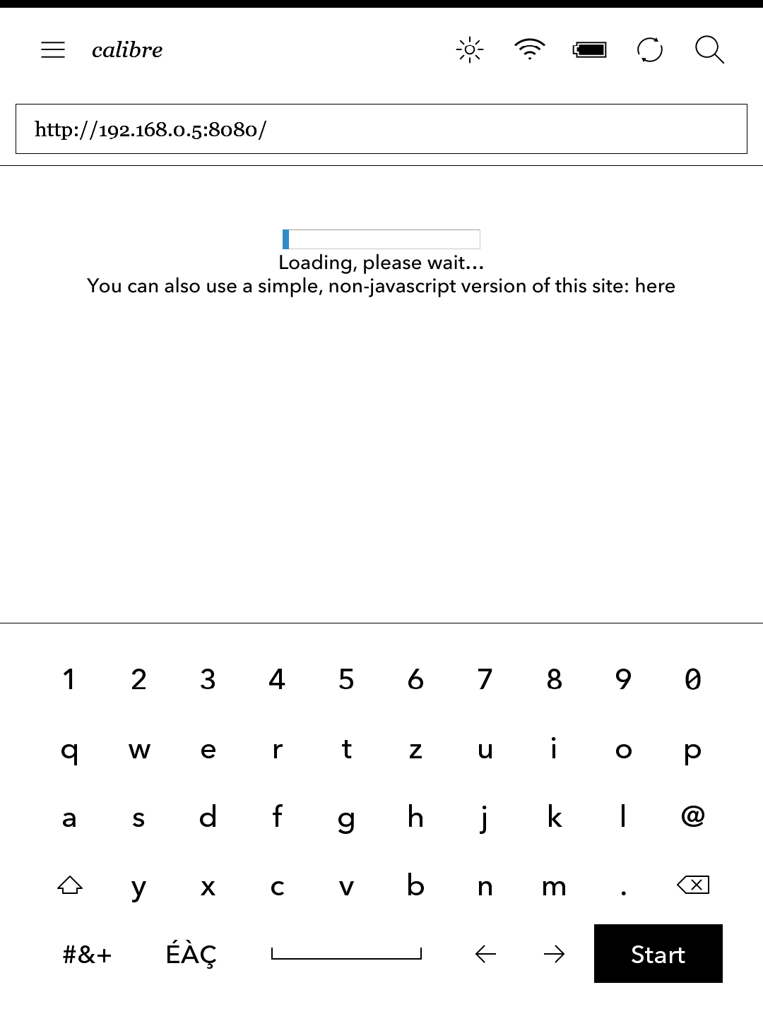

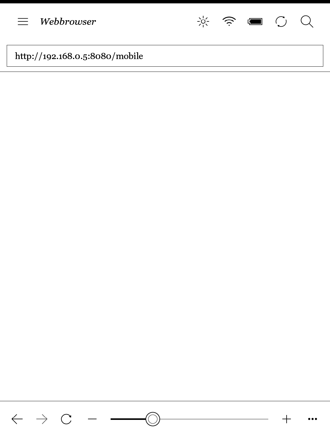

Old 05-30-2017, 01:26 PM   #394
Martina Schein
eBook-Reader-Fan
Martina Schein ought to be getting tired of karma fortunes by now.Martina Schein ought to be getting tired of karma fortunes by now.Martina Schein ought to be getting tired of karma fortunes by now.Martina Schein ought to be getting tired of karma fortunes by now.Martina Schein ought to be getting tired of karma fortunes by now.Martina Schein ought to be getting tired of karma fortunes by now.Martina Schein ought to be getting tired of karma fortunes by now.Martina Schein ought to be getting tired of karma fortunes by now.Martina Schein ought to be getting tired of karma fortunes by now.Martina Schein ought to be getting tired of karma fortunes by now.Martina Schein ought to be getting tired of karma fortunes by now.
Martina Schein's Avatar
Posts: 175
Karma: 444178
Join Date: Sep 2012
Location: Saarbruecken / DE
Device: Kobo Aura H2O 2nd Edition
Today I tried to connect my Kobo Aura H2O to the Caliber server. With my smartphone that worked well.
The simple page link is displayed after the call, but after a tip on this link nothing happens. No login is displayed, only a blank white page. The screenshots illustrate this.
I think, however, that this is due to Kobo. Even after years the browser still has the beta status.
I do not even need this function on my reader, because I copy the eBooks by means of Calibre via USB.
Now and then I like to play with my gadgets and try what is possible.
I have tested it with Calibre 2.99.9.
ID:	157116   Click image for larger version
Martina Schein is offline   Reply With Quote

@Martina: Yes the Kobo browser has lots of problems with the new server, see previous discussion with davidfor and m. s.
The UI seems to be fine here. Last night I saw the javascript-free prompt and pressing "here" took me to the mobile version. The list displayed fine with the books and details. I did do one search and reordered the list without any problems. The only problem I see is downloading books.
