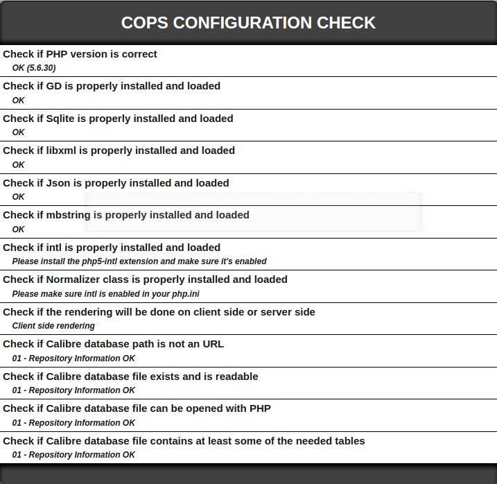

FYI, attached is a jpeg of the checkconfig screen, so line 1 is ok.
However, per the hints, I checked php.ini for any mention of "intl" or "Intl" and no hits.
In previous setups I had installed Entware because it had the Intl php5 module. but I noticed that line in the check config screen never says OK, just to check Intl installed and activated.
But I am holding off Entware to keep the system as clean as possible while trying to get this to work. So I don't know if Intl ever got loaded in php.ini or not, even with Entware.
Could that be part of this problem?
I also attached a txt file of the loaded apache modules. Not sure how to tell if they are available to the "QNAP Webserver", but the list shows ALL apache modules, according to the qnap guides.

1 - checkconfig.php looks OK
-> the missing intl is no problem. Probably only used with latin (French, Spanish, etc) languages. Just disregard any messages about intl. Not a part of the problem.
2 - the text file list (as you said) all the available modules not just the "active/loaded" ones. But if .htaccess authentication works(worked once) then there should be no problem.

<Directory "/share/Web/COPS111">
    Options FollowSymLinks MultiViews
    AllowOverride All
    Require all granted
    AuthType Basic
    AuthName "RESTRICTED AREA"
    AuthUserFile /share/Web/COPS111/.htpasswd
    Require valid-user
</Directory>
3 - to make a change in an apache config file work, apache needs to either be restarted or the config files should be reloaded. Rebooting the QNAP has the same effect.
This all probably explains (hopefully) why authentication did not work. I hope it does now.
Well I have the same with NGINX. For me apache usually works after a lot of
while NGINX does not.
You got that right!
I still have the Apache setup, so will give your idea a try. But I relented and installed the latest QApache, which was what I was using before when I had cops in /share/htdocs.
And, I actually had it working for two users, briefly, then I screwed something up. The last time I had it fully working, I had to put all the cops files in /share/htdocs. It appears the correct way is to have it in /share/htdocs/COPS111 and that is where I run into problems.
But, working my way in the old learn-by-doing thing, LoL.
Question: How does COPS save individual user settings? Cookies?? Because everytime I go back into a different user, the settings are all gone. They seem to stick if I don't clear the cache. If this is the case, it means the user cannot clear their local caches and delete cookies, right? Tell me it ain't so!!
