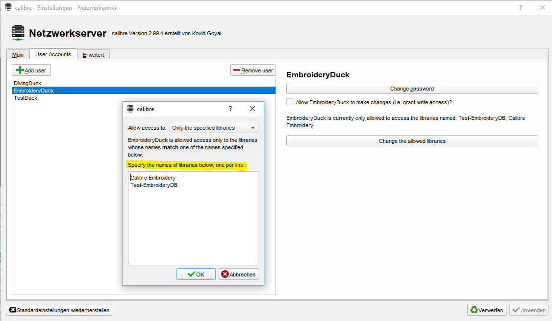

I will do today some further tests with the server. Have you already wrote some documentation for the new functions and CLI changes? It would be fine to have something preliminary.
One thing I recognize by setting up the limited access for users was that it would be nice to have a selection box for existing libraries so that a admin do not need to search the libraries.
It seems that I loose from time to time the covers from the first page again (as already reported). I need to check more systematical these issues.
Any idea about the issue with restricted user account logins?

@DD I still have to look into the issues you first reported, problem is I find them hard to replicate.
As for documentation, not really. I prefer to write documentation one the features are a bit more mature so I dont have to go back and change things.
Certainly the restrict libraries dialog can be made more friendly to use.

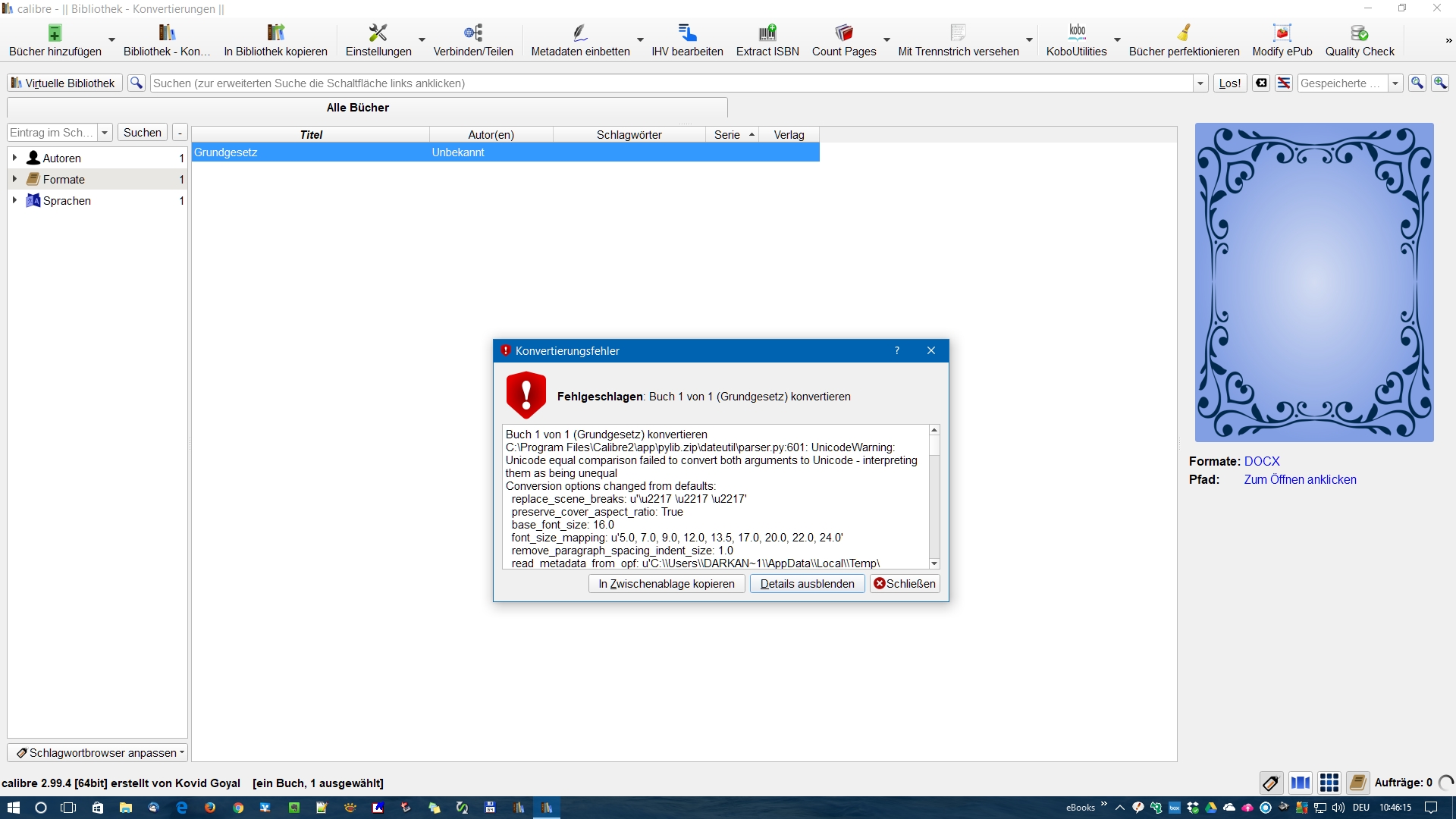

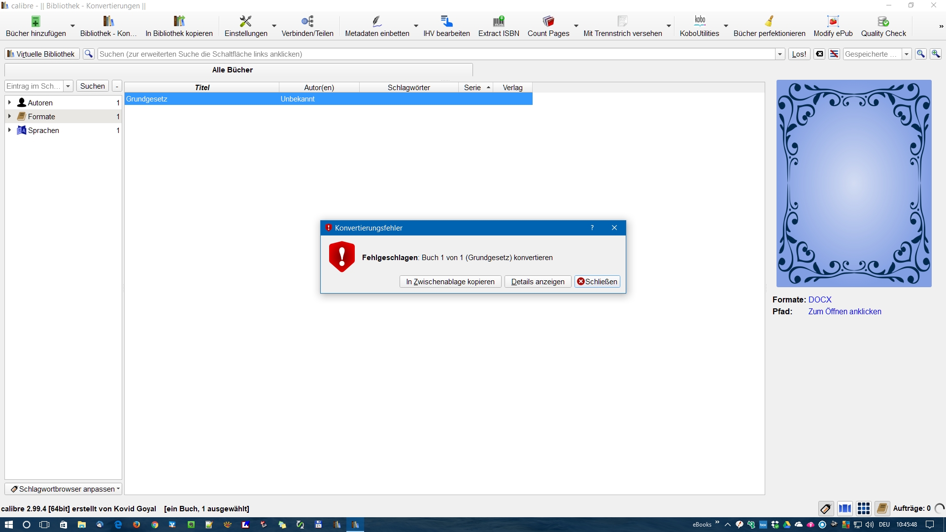

@Martina: I dont think that;s a bug in the beta, it would have happened in calibre 2.x as well. Regardless, this should fix it: https://github.com/kovidgoyal/calibr...c70f08cd89936b
It is correct Kovid. The error also occurs with version 2.85, which my husband has installed on his PC.
However, we do not get the error for all Word files that we have converted from PDF documents, but only at some.
This is not noticeable to me before, since we almost work with ePubs.
Released beta version 2.99.4 with fixes for the issues reported by DivingDuck and Martina
Thanks a lot.
Addendum:
This error still exists. With my test document I still get the error message.
calibre, version 2.99.4 (win32, embedded-python: True)
Konvertierungsfehler: Fehlgeschlagen: Buch 1 von 1 (Grundgesetz) konvertieren

InputFormatPlugin: DOCX Input running
on C:\Users\DARKAN~1\AppData\Local\Temp\calibre_kcrn3 v\o4k_xw.docx
Settings word/word/settings.xml do not exist
Styles word/word/styles.xml do not exist
Numbering styles word/word/numbering.xml do not exist
Converting Word markup to HTML
Python function terminated unexpectedly
'Styles' object has no attribute 'theme' (Error Code: 1)
File "site.py", line 101, in main
File "site.py", line 78, in run_entry_point
File "site-packages\calibre\utils\ipc\worker.py", line 195, in main
File "site-packages\calibre\gui2\convert\gui_conversion.py", line 33, in gui_convert_override
File "site-packages\calibre\gui2\convert\gui_conversion.py", line 26, in gui_convert
File "site-packages\calibre\ebooks\conversion\plumber.py", line 1088, in run
File "site-packages\calibre\customize\conversion.py", line 245, in __call__
File "site-packages\calibre\ebooks\conversion\plugins\docx_in put.py", line 34, in convert
File "site-packages\calibre\ebooks\docx\to_html.py", line 122, in __call__
File "site-packages\calibre\ebooks\docx\to_html.py", line 429, in convert_p
File "site-packages\calibre\ebooks\docx\to_html.py", line 678, in convert_run
File "site-packages\calibre\ebooks\docx\styles.py", line 314, in resolve_run
AttributeError: 'Styles' object has no attribute 'theme'

@Terisa de morgan, only a couple
But you are right. I just rename one and regognize that the server didn't recognize the library. I do see also a double entry of one other library in the web-gui. calibre seems to save the drive location two times with drive location e:\... and E:\...

@Martina: In that case, please open a bug report and attach one of these DOCX files as it looks like there are many things wrong with it that I will have to handle.

@DD: No, the server uses HTTP authentication, not cookies. So it is not possible to have multiple users in the same browser. This is a limitation of HTTP authentication, and the server has to use it because it also has to work within non-browser software like OPDS readers. Yes, the name should be shown inside the web gui -- I just have not gotten around to implementing it yet.
@Terisa: if you run the server from the calibre GUI it should be all libraries the GUI knows about. You might have to press refresh in the browser to see them. When you say looking for books by genre, you mean doing a search inside a virtual library?
