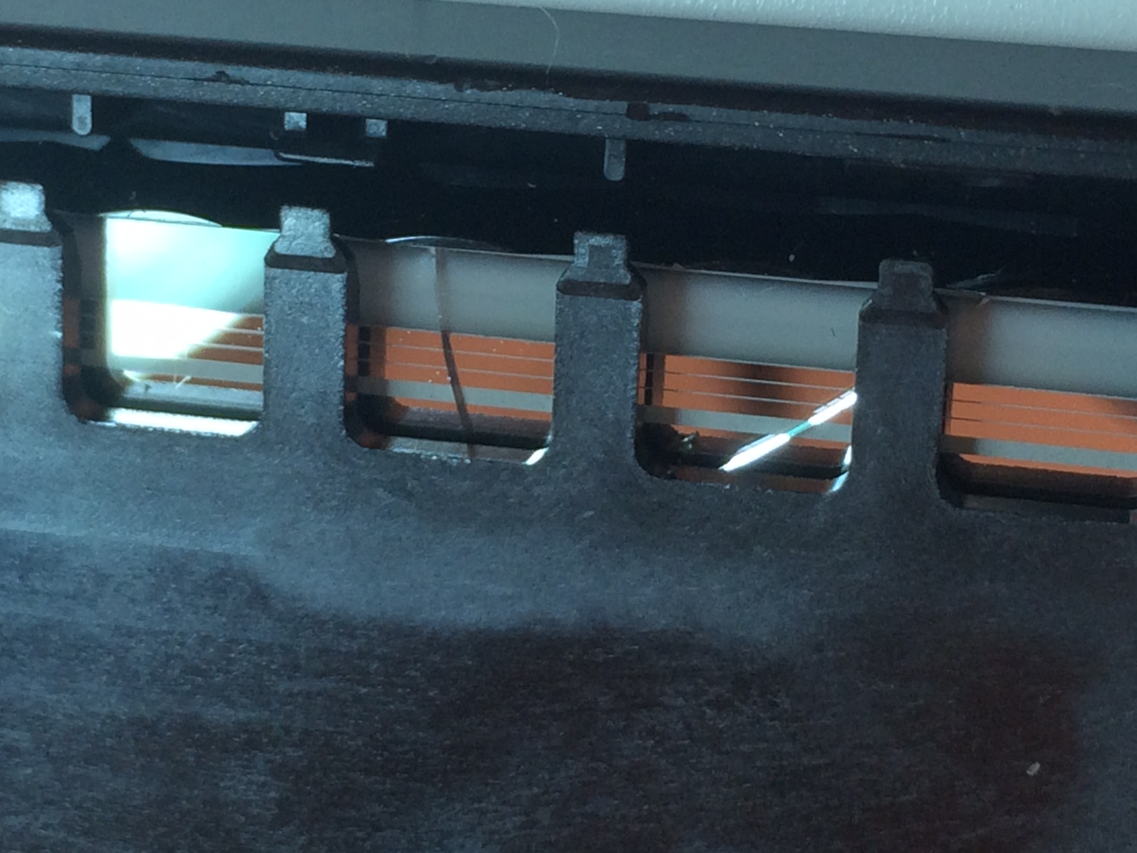

I'm sorry but I didn't foresee a broken screen.
I'm new to e-paper screen and I was thinking of a sort of last memorized page that was degrading in time.
There is no external sign of impact on the screen or the case (take a look at the images). The owner didn't talked about an incident, only about a frozen reader.
I'will report on the logs, I imagine that the boot should appear standard but no reacting screen.
Thanks

Those images clearly show a broken substrate. If you do a search here or elsewhere, you will find many readers of all brands with broken screens looking the same.
How it was broken, I don't know, I'd be tempted to think something sharp hit it near the end of the light area going across the screen. But, it might have been something else. And it might have been gradual. If there was bad bump on the screen, it can start a crack you can't see and then twisting the device a bit while using can extend it. Until you get what you are seeing.

Here I am,
I finally got the serial converter and read the boot log from the console ...
The log is attached but here is the evidence:
U-Boot 2009.08-00784-ge26a520-dirty-svn2940 ( 1æ 13 2015 - 14:27:41)
CPU: Freescale i.MX6 family TO0.0 at 792 MHz
Temperature: 29 C, calibration data 0x57c5015f
...(omitted)...
Starting kernel ...
drivers/misc/ntx-misc.c(msp430_i2c_probe): Can't allocate irq 395
[zForce_ir_touch_recv_data-259] command BootComplete (0)...
PMU: ricoh61x_battery_probe : version is RICOH61x_BATTERY_VERSION: 2014.02.21 V3.1.0.0-Solution1 2015/02/09
drivers/video/mxc/lk_tps65185.c(568):tps65185_int_func under-voltage on VEE charge pump detected !
The last message is repeated continuously intervalled by a line like:
drivers/video/mxc/lk_tps65185.c(1380):wait power on timeout lpcnt=0!
in which lpcnt counts up each 36 messages til
cannot open /dev/nulldrivers/video/mxc/lk_tps65185.c(568):tps65185_int_func under-voltage on VEE charge pump detected !
then we got
dosfsck 3.0.6, 04 Oct 2009, FAT32drivers/video/mxc/lk_tps65185.c(568):tps65185_int_func under-voltage on VEE charge pump detected !
, LFN
There are differences between boodrivers/video/mxc/lk_tps65185.c(568):tps65185_int_func under-voltage on VEE charge pump detected !
t sector and its backup.
Differences: (offset: original/backup)
489:8d/00, 490:ef/00, 491:02/00, 492:d2/00, 494:ff/00, 495:ff/0drivers/video/mxc/lk_tps65185.c(568):tps65185_int_func under-voltage on VEE charge pump detected !
0, 496:ff/00
, 497:ff/00, 498:ff/00, 499:ff/00, 500:ff/00, 501drivers/video/mxc/lk_tps65185.c(568):tps65185_int_func under-voltage on VEE charge pump detected !
:ff/00, 502:ff/00
, 503:ff/00, 504:ff/00, 505:ff/00, 506:ff/00drivers/video/mxc/lk_tps65185.c(568):tps65185_int_func under-voltage on VEE charge pump detected !
, 507:ff/00, 508:ff/00
, 509:ff/00
Not automatically fixingdrivers/video/mxc/lk_tps65185.c(568):tps65185_int_func under-voltage on VEE charge pump detected !
this.
So it clearly shows up an hardware error.
It seems a problem on the negative voltage (VEE) converter in the e-paper display power supply IC (TPS65185) not reaching the right level (-20V).
luke73 is offline

removed the motherboard ...
found the broken display ....
OK, I leave.
Thanks to all of you for your time.
Bye
G
